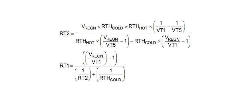

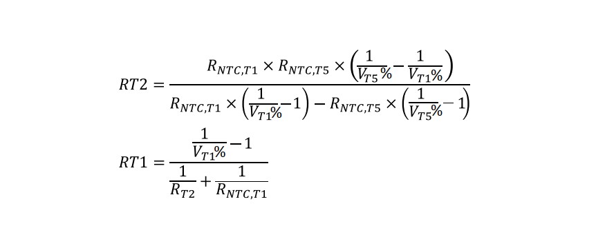

Hi Sir/Ms.
I have 2 version BQ25606 specification.  Sir/Ms.
I have 2 version BQ25606 specification. About RT1 & RT2 calculation have two formulas. I don't know what's right.
Related instructions are as follows:
Best Regard,
Taurus
  • Hi, in BQ25616 datasheet, we updated the datasheet with percentage of REGN. Previous VREGN/VT1 becomes 1/(VT1/VREGN)=1/VT1%, where VT1% can be looked up from the EC table in the datasheet directly. As matter of fact, the equation is independent of VREGN so the new equations is more straight-forward. But those equations have different form of expression only.
