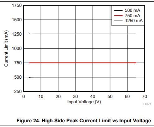

  • Hello David,
    Figure below is for 5V ooutput.
    Average current is based on inductor selection, as peak inductor current defines current limit.
    Please see figure below from D/S to understand device current capability at low VIN/high duty cycle.
    Does this answer the question?
  • Yes and no.  These ratings are for peak switch current, and I do understand how peak switch current determines average output current.  The disconnect is that the high side switch is rated for 1250mA peak current, but section 6.3 states that the max output current is 500mA.  If the part is not switching and I allow 750mA or 1250mA to pass through the part, I am violating the max output current.  When the part is switching the peak current is not the same as the average current, so I fear that this 100% duty cycle mode is an exception and the 500mA max output current is what applies.

  • Hi David,
    Yes, the current can go as high as 1.25A in PFM and 100% duty cycle. If this is a concern, then you can choose COT operating mode.
    Tim
