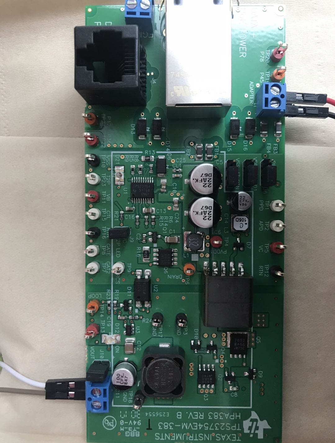

I didn't plug in a PSE, and only input 50V through the J1 plug(the adapter plug),and I've tried with and with a load through J2 plug(the OUTPUT plug),finally it could not output 12V at J2, it was 0V all the time. Is there any preset I missed or is there something wrong with the EVB?
  • Hello Jane,
    Can you confirm the position of the jumpers?
    Additionally, can you show the startup waveforms of VC, PVDD, GATE, and VB? This will help me understand if the IC is getting powered, and if so, is it damaged. Thank you!

  • Hi Michael:
    I've checked the jumpers,not connected well .Now the output of J2 plug(the VOUT plug) is 14V(the input is 50V). The output LED is lighted.
    The voltage on PVDD1 testpoint is 54V , the voltage on VC testpoint is 13V, and the voltage on VB is 5.8V. The startup waveform of GATE is shown belove:
    I wonder why the output voltage of VOUT(J2) is 14V instead of 12V?
    I am looking forward for your reply sincerely.
  • Hello Jane,
    I am glad to hear you are getting an output voltage now.
    Can you confirm again the jumper positions?
    Also, can you provide a waveform of Vout? I am curious to know if it is stable or if it is changing.
    Lastly, what is the load on the EVM? Is is electronic or resistive?

  • Hi Micheal:
    The Vout changes slightly as the photo of it's waveform which is attached below , and the load of the EVM is resistive (10-25Ω).

  • Hello Jane,
    What is the 12.13V and the 12.14V? Looking at the tick marks, I can see three tick marks above the voltage line, presumably indicating 14V, 16V, 18V, and then the next line being 20V. This would indicate the voltage is about 12V.
    Can you try using a smaller volts/division to get a more accurate picture?
