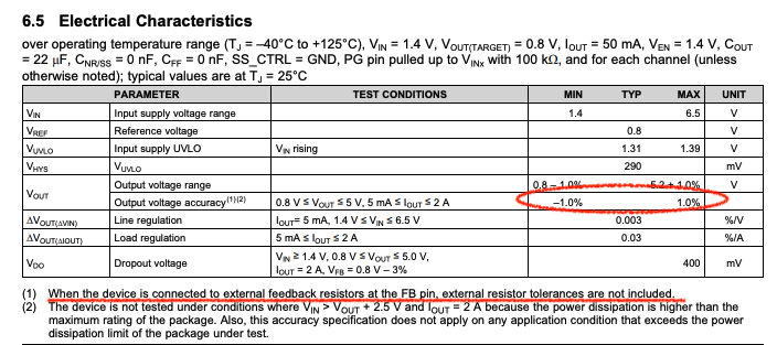

Hello E2E,
Can you tell me what the tolerance is on Vref? Is there a min/max we can design to?
Thanks!
Russell
