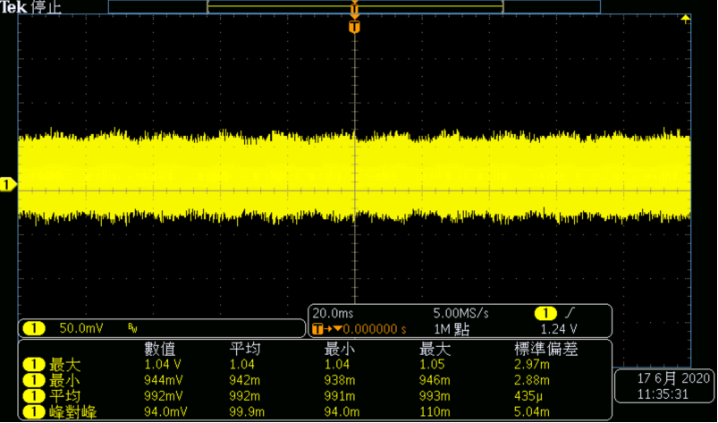

As title, my customer has faced the  high ripple problem at full load. It is about  100mV ripple.

    How's the ripple at light load? Can you please probe the switching node as well? How's the way customer measuring the ripple? They should use pig tail or differential probe, which one did they use? You can try to use TI GUI to change RAMP from 150mV to 200mV to see if it helps.
  • hi Chasel,
    Customer tries to adjust ramp level to get better ripple.
    ramp level: 150
    light load ripple: 60mV,
    ramp level: 200
    light load ripple: 76mV,
    ramp level: 40
    light load ripple: 22mV,  heavy load ripple: 32mV

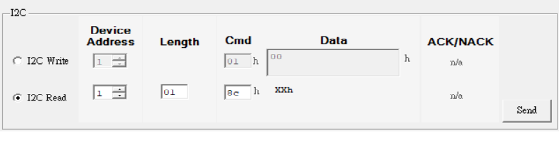

    -how can i use USB to GPIO tool to read the current information on the GUI? how to fill the address and length?

  • Hi Frank,
    - should I adjust ramp level to reduce the ripple?
    You can change the ramp to 200mV to reduce the ripple, usually to increase the ramp will make the ripple lower, but from your result it is opposite...
    -another concern and how to make sure it's ok like jitter performance?
    How's the jitter waveform looking like?
    You can refer to the PMBus spec in the datasheet or use the TI GUI, you need to use the PMBus command.
