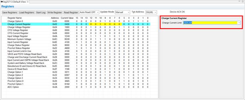

  • Hi, SHH,
    We use BQStudio to set the register settings. We don't have other tools. The right panel shows the check boxes, it is straightforward. Most of the default values should be sufficient for the customer, you only need to set the charge current when starting charging.

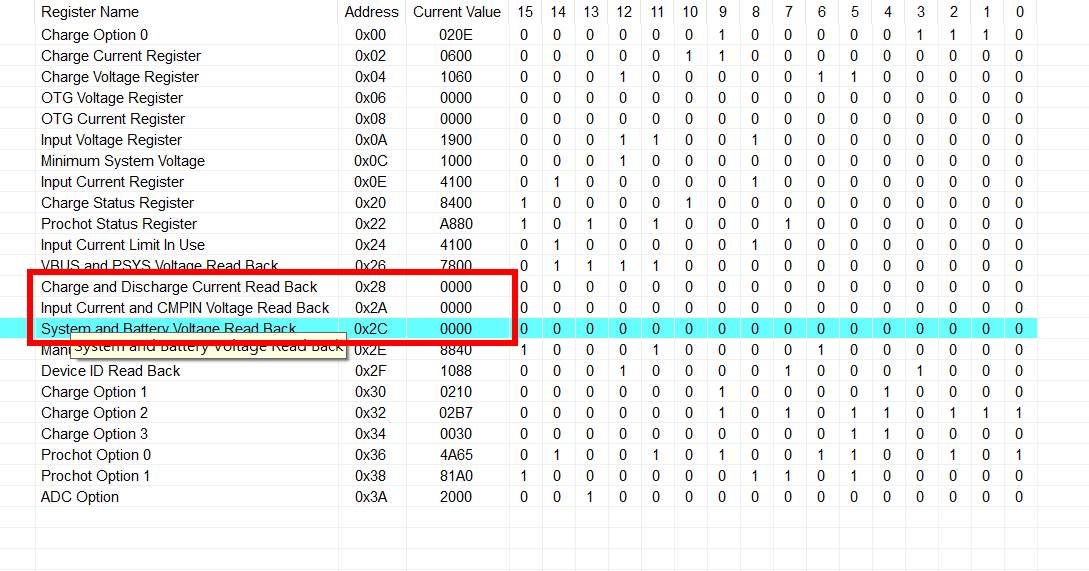

    the following register seems not be able to read, is that right?
    BR,
    SHH
  • You need to enable ADC conversion in register ADC Option 0x3A. The ADC is disabled by default.
