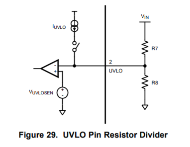

I'm designing the UVLO circuit using LM3481 for my application.
To verify the worst case limits of enable & shut down of my converter, I would like to know how Vuvlo & Iuvlo parameters vary w.r.t temperature.
From data sheet I read that Iuvlo will vary from 3uA to 6uA over -40C < Tj < 125C. But at what temperatures do the minimum and maximum will happen?
Similarly for Vuvlo, at what temperature the UVLO comparator threshold maximum and minimum will happen?
Any relevant graphs of these parameters' variation w.r.t temperature are very much appreciated.

  • Hi Chaitanya,
    This data is not available. Furthermore, the UVLO threshold is based on the bandgap voltage which is supposed to be flat over temp so we cannot give trend as far as high UVLO at high or low temp.
    A trimmed bandgap is ideally flat over temp but from part to part it can be slightly positive TC or slightly negative TC so again, we can not give a definitive trend.

  • Hi Chaitanya,
    Here is what I got.
    • The UVLO voltage is directly based on the reference voltage and is flat over temperature.
    • The current value will depend more on the resistor value which is not corelated to the Vref tempco. In other words there is no correlation between the UVLO voltage and current but both should be ideally flat over temp.
    Yinsong
  • Hi Yinsong,
    Thanks again for your efforts in bringing this information to me.
    Just to confirm my understanding of your second statement, are you referring "the resistor value" to the R8 resistor in potential divider (see image attached).
    What is the equation that governs the Iuvlo current?
    Chaitanya K
  • Hi Chaitanya,
    The resistor is inside the chip that relates to the current. We may not be able to go into too much details about the design inside the chip.
    But the conclusion holds that there is no correlation between the UVLO voltage and current but both should be ideally flat over temp.
