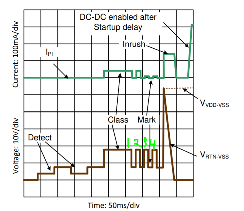

I’d like to use SCDIS mode to determine power allocated by PSE

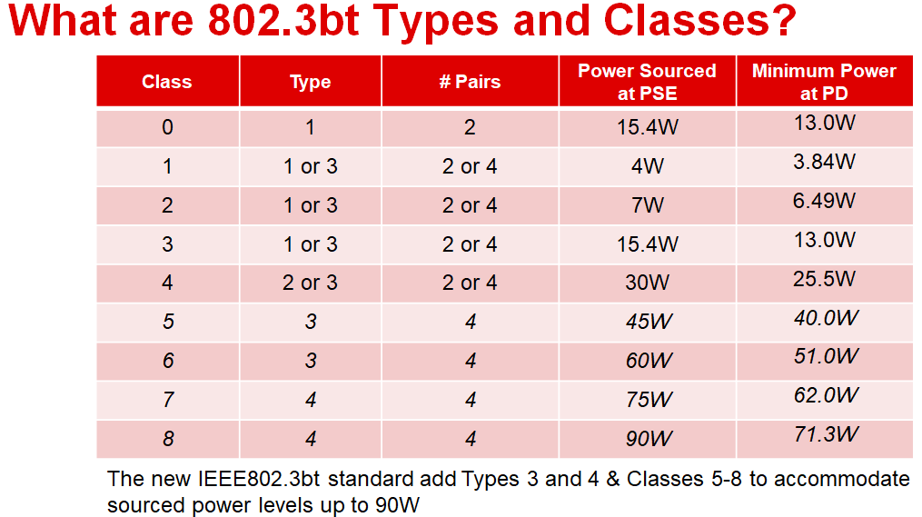

I’m confused as to how I’m meant to determine between a 40W and 51W power allocation, for my application I need to know if I’ve got the full 51W available or not.
I note that if I don’t use SCDIS I seem to also have the same issue?
