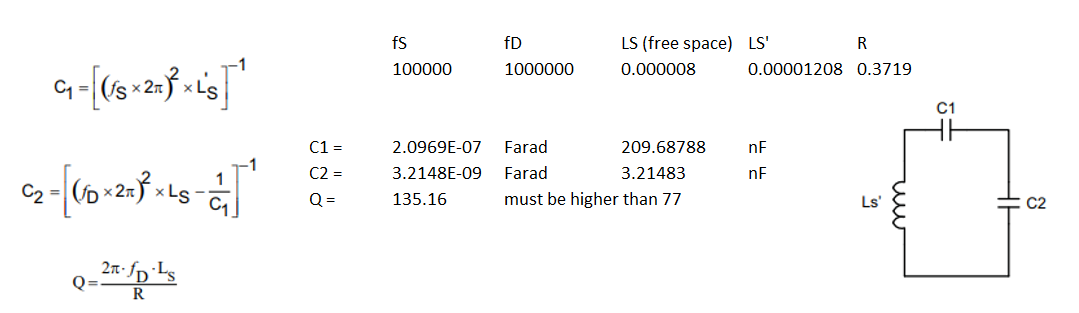

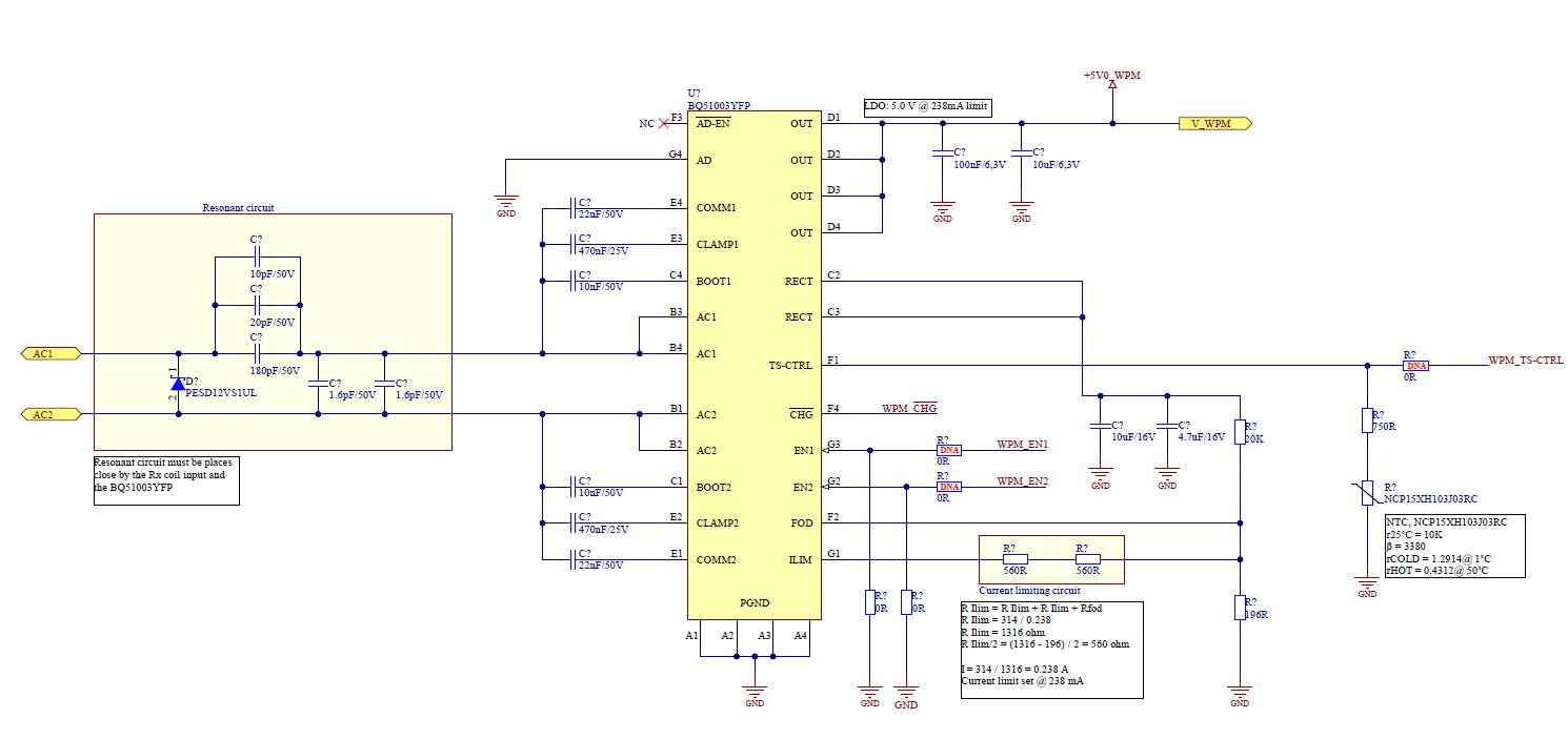

my question is, if you could review my schematic part of the wireless charging circuit.
the RX coil is the TDK WR303050-15F5-G, for the calculations see attechments.
your review would really help me.
thank you in advance !
