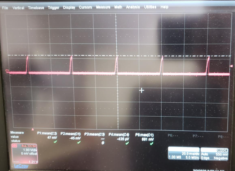

The load draws only a couple hundred milliamps from the PowerMUX 5V output. At the time the damage occurred, the load was on steady state. The IN1 state should also have been a solid 5V the entire time. The damage happened when a cable harness was connected to the IN2 signal (but I believe was unpowered, unless there was a cable malfunction, but even then I only have 24VDC at most available in that harness).

So far it is a single board that failed while I wasn't expecting to be stress testing boards. I tried ESD zapping a second board through a cable harness that leads into that IN2 connection and have been unsuccessful at causing the power mux to fail in a similar way.
Is there anything about the described type of damage I observed at the chip that tells me anything about the path of energy that killed it? (70 ohms across the output, the attempt of the power switch to cycle on from IN1 path to the output whereas no attempt at all to power on from IN2 path to output)?
