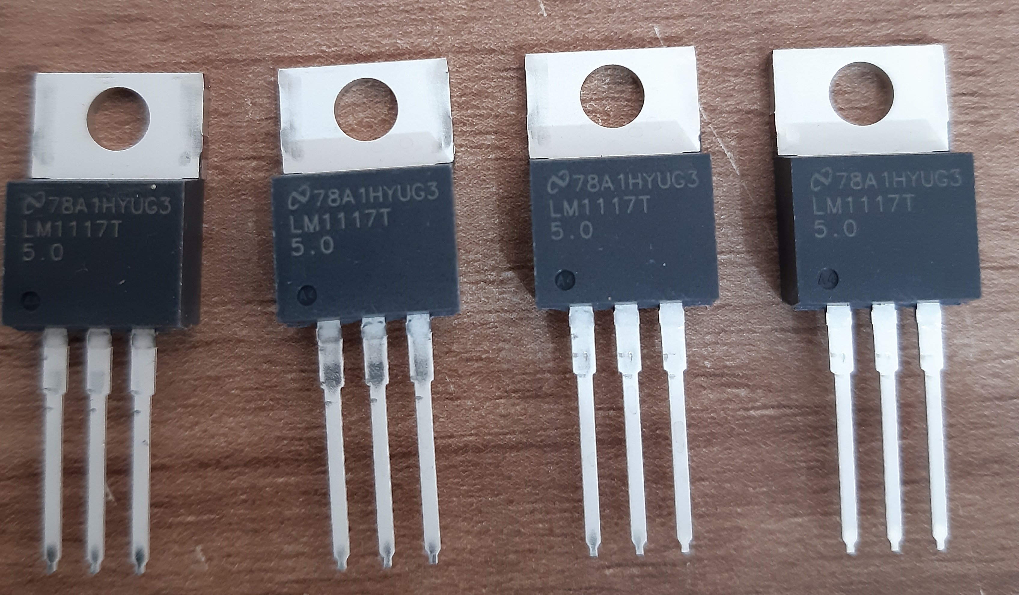

I bought some LM1117T-5.0 regulators this week directly from TI and i found out a old data sheet (August 2000) for LM1117 National Semiconductor that says the following:
"The ESR of the output capacitor should be less than 0.5Ω".
However, the TI´s data sheet says: "The ESR of the output capacitor should range between 0.3 Ω to 22 Ω ".
What value should I use ?
