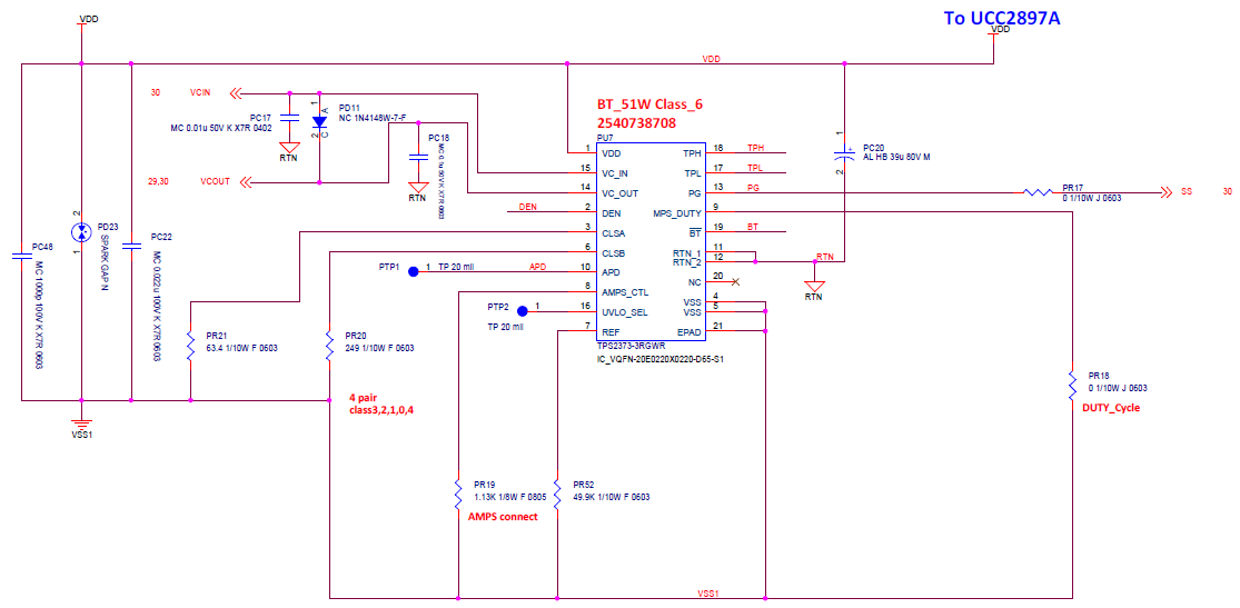

Dear Team,
This circuit will shut down during 42V running overnight.
Do you have ideas what may cause the circuit shut down?
BR
Kevin

  • Hey Kevin,
    What power level is the load providing nominally?
    Can you provide a schematic?
    Can you tell me more about the situation? Does the customer come in the morning and their device is no longer connected? Are they monitoring the device and seeing it be dropped? How many times a night does it drop?
    Does the output drop or does the whole system shutdown?
    What does it take to reset?
    I will need more information to confirm, but the first thing that come to mind are thermal overheat somewhere.
