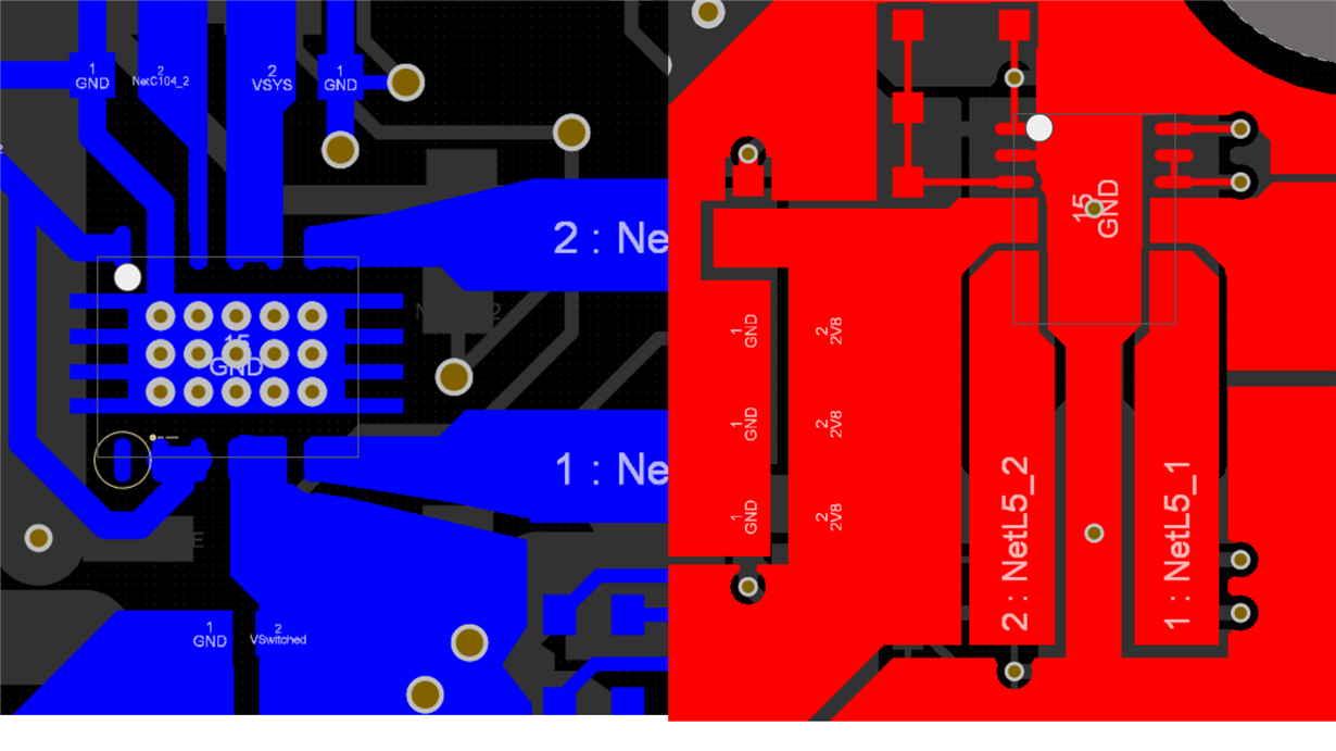

    Can quickly share the layout as a couple of screen shots as I don't know a better way:
    Left is the regulator depicted in the top schematic with VSwitched coming in the bottom and VSys leaving the top. Faint outline is my doing to show the regulator position relative to the pads and white dot represents pin 1
    Right, top side of the board is the second regulator. They are separated by about 3 cm and connected through a power plane. Orientation is rotated 90 degrees but pin 1 is still denoted with a white dot.

    Additionally the layout is importance to ensure the switching power performance. According to the layout you showed, the caps are far away from the IC. For a buck-boost converter, the input and output caps should be put as close as possible to the ICs, and make the trace shortest. You could check the layout guidance of the datasheet or take the EVM layout for reference.
