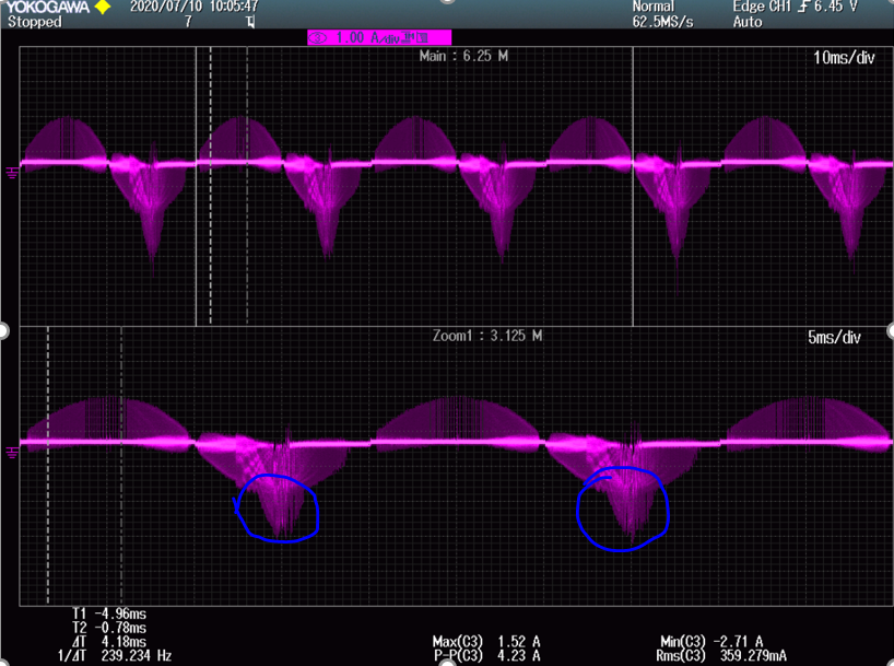

    I have other issue about 28070; we set PFC output  bus voltage = 410V; Vin = 288V;  load = 40W  two channels are interleaved in parallel;
    input current  come out strange wave ,
    as follow pic,
    Ch3: input current;

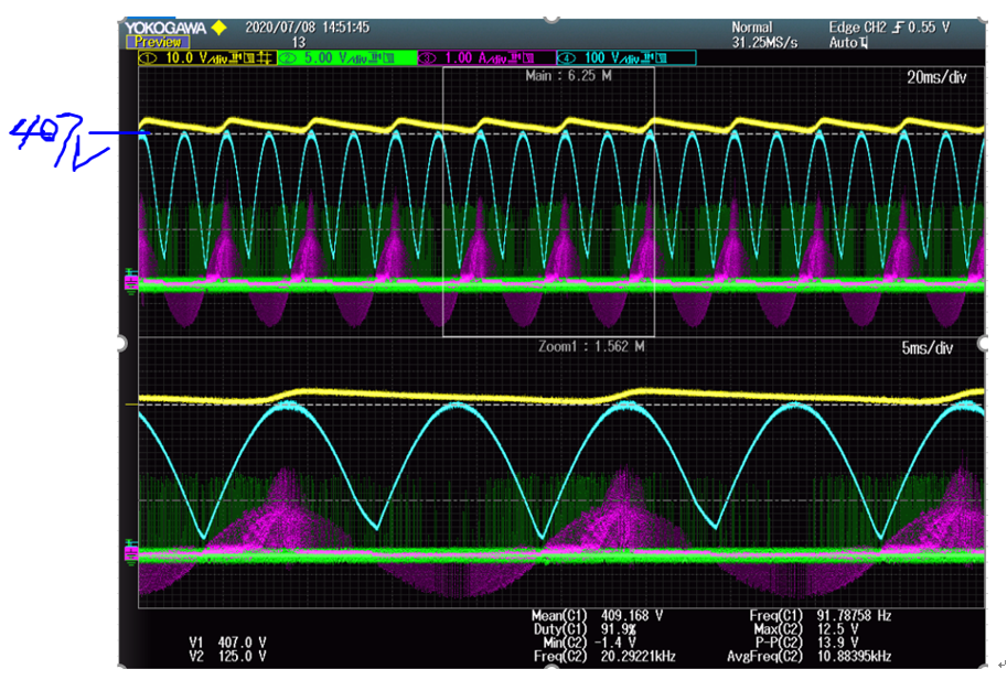

    I doubt Vin is too high, then obtain the belo
    Ch1:PFCVout; ch2 DRB;ch3 input current ;ch4 input voltage;

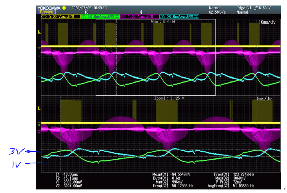

    We can find Vout > Vin all the time , it explain it is not the root cause ; then we doubt output power is too low, and then we obtain the below wave;
    Ch1: DRA; ch2: VAO; ch3: input current ; ch4: Vsense;
    We can conclude VAO > 0.75; so it is not root cause;
    One question :  Vsense > 3V , GDA,GDB is prohibit ?
    from pic GDA,GDB is not probit.
    Two question: input wave as below pic show on which condition ?
    28070.docx
    please advise ,thank you very much !
