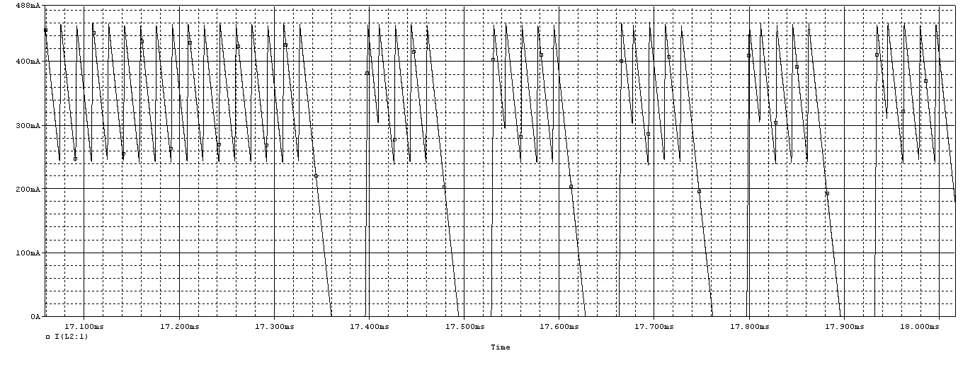

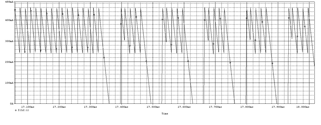

Here is the transient simulation.The  Run to time(TSTOP) is 40ms and the PSpice A/D result is :
As the plot show,the current of L2 is CCM before 17.3ms,but is DCM after it .Can you tell me why ?Thank you.
Alice
    The UCC28881 uses an on/off control scheme the inductor current seems to be correct.
    Please refer to figure 13 in the data sheet.  When FB is less than 1V the controller will deliver 62 kHz switching packets.
    https://www.ti.com/lit/ds/symlink/ucc28881.pdf
    There was an application not that was written for the UCC28880/1 to reduce audible noise.  Figure 3 of this application note gives a better representation of how the UCC28881 compared to the data sheet.  Also figure 3 shows output ripple voltage and inductor current.  You will observe that the waveform you are observing in simulation is similar.
