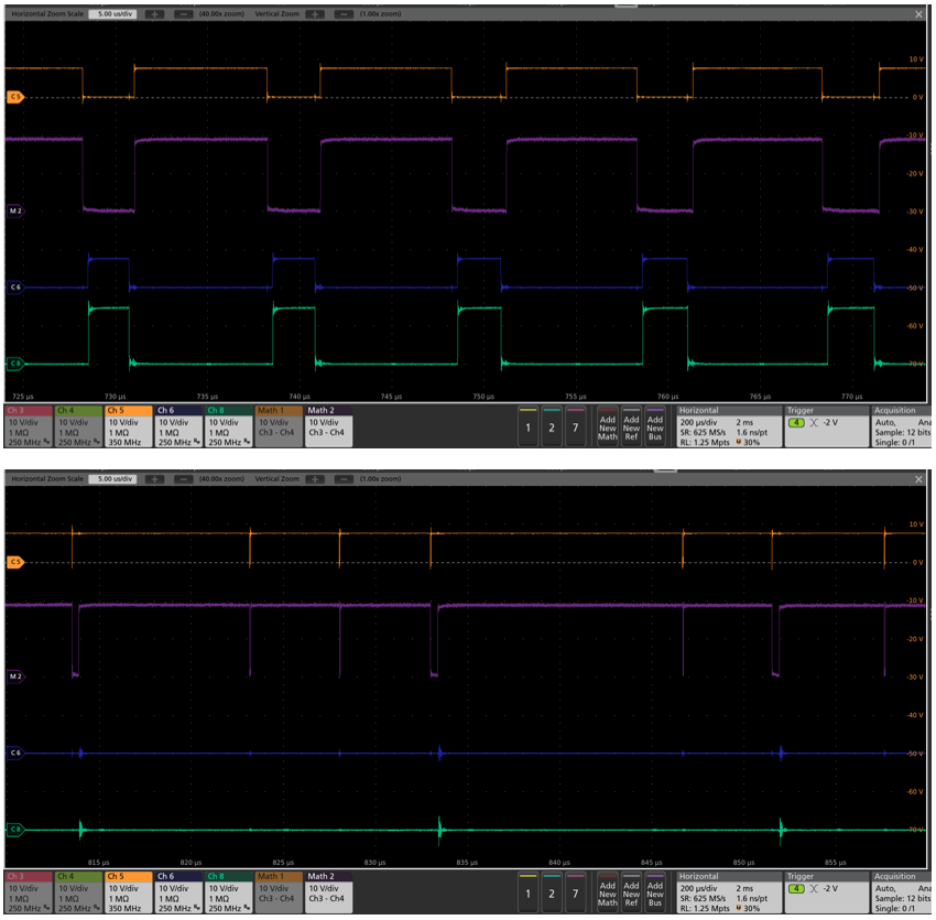

UCC27211: 400ns-off output when 40ns-off input
Part Number: UCC27211
Other Parts Discussed in Thread: UCC27282,When HI input signal is 40ns off, I assume HO output is 40ns off or nearly 40ns off. But, I found that HO output is often very long off (400ns off). Usually, HO output is 40ns off. Is there a way to get rid of this random very long off? Datasheet 7.9 says, minimum input pulse width that changes the output is MAX 50ns. When input pulse is less than 50ns, dose this IC work wrong?

  • Hello Richard,
    Here are my waveforms.
    Ch5, orange color, is HI-VSS
    Math2, purple color, is HO-HS
    Ch6, blue color, is LI-VSS
    Ch8, green color, is LO-VSS
    The VDD voltage is about 15V – 19V.
    The operating frequency is not stable, since these are pulse-generator shutting-down waveforms.
    The MOSFET Qg is 35nC max.
  • Hello TkMk,
    Thank you for the waveforms. I do see the behavior you are questioning. It is hard to see what exact pulse widths of the negative going HI input are showing the difference in the HO response to the shorter width low to the wider width low pulses in question.
    Is there some way you can get a pulse width indication of the HI showing the expected HO response and the longer HO low response.
    I can see the HI looks a little shorter when it looks like the HO goes low for a longer period.
    This may be getting close to the minimum pulse response mentioned in the datasheet. Is this behavior an issue in your system, or more of a question of why this is happening.
    There is a newer 100V driver which does have specifically improved narrow pulse response, although the datasheet parameters look similar. The UCC27282 does have very good narrow input pulse response which you may want to consider,

    Also I want to confirm the plots you attached ealier showing the normal HO-HS low pulses and the long HO-HS pulses are at 200ns per division. Can you confirm?

    You see 4 plot images. First and second are 5us per division. Third and fourth are 100ns per division.
    Regards, TkMk
  • Hello TkMk,
    It is not very straightforward to determine the couple of items I would like to confirm, I did look at the strings of data and looking at the M column to determine the extended HO-HS low amplitude.
    Can you point out the HI narrow low pulse width where the HO-HS response looks as expected, and also the HI narrow low pulse width where the HO-HS has the extended low level pulse width. I would like to confirm if the pulse widths are getting narrower when the output response does not look correct, or wider in pulse width (low going).
  • Hello Richard,
    I added columns and plots to xlsx.
    I found that,
    is more than 28ns,
    is less than 26ns.
    So, the input pulse width is narrow when the output response does not look correct.

  • Hello TkMk,
    Thank you for confirming the pulse widths where the HO operation is as expected, and there is extended low pulses.
    You may want to consider testing the UCC27282 which does have improved narrow pulse response, the datasheet can be found here: https://www.ti.com/lit/ds/symlink/ucc27282.pdf?ts=1595442568623&ref_url=https%253A%252F%252Fwww.ti.com%252Fsitesearch%252Fdocs%252Funiversalsearch.tsp%253FsearchTerm%253Ducc27282
    Is the response to the narrow pulses such as 24ns required, or is thin only in the case of possible input noise concerns?
    If this narrow response is not required, and it may be a noise concern, you should consider adding a small R/C filter on the driver input pins.
  • Hello Richard,
    I have to modify the title. It is 400ns-off output when 24ns-off input.
    In my case, narrow response is not necessary. So, I will make UCC27211 not to receive narrow pulse or narrow noise.

  • Hello TkMk,
    When I inquired about the possible response of the UCC27211 the behavior that had been confirmed was regarding the narrow positive pulses but the discussion confirmed that narrow negative pulses will have similar behaviors.
    The UCC27282 does have a improved specification and actual behavior is improved over many half bridge drivers. The specification implies in one regard that the output will actually respond to the narrow input pulses but in practice also includes the output being close to the input pulse width.
    If you can avoid the narrow input pulses which I thought would be the case in your application, the UCC27211 will be OK for your operation. If you want to explore a device with better narrow pulse behavior I recommend the UCC27282.
