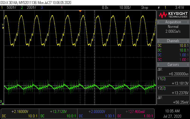

Schematic in attachment, when we have 30-45mA load the voltage drops to +-12,4/12,5V. How to fix this?

I wonder the converter enters into power save mode with such load. Please catch the waveform at Vin, Vout, SW to check it.

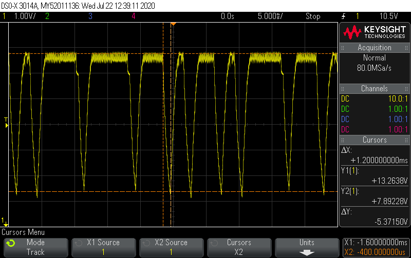

According to the waveform of Vin and Vsw, it seems the Vin drops obviously. May you check the valley value of Vin? The UVLO of TLV61048 is 2.4V.
Vin drops to 2.4V (but this is caused by the boost conv.), will now do a cont. load test instead of the oled.

From 72mA loads it starts getting stable, but our loads are 0-60mA, we even burned a screen by connecting this IC ...
Ps.: here I changed to 1MHz, will go back to 600k now.
Greetings
Thomas Van Aken
600kHz same behaviour, but gets more stable after a lower current (45mA+-), still this can blow our 3V3 IC when we don't draw any currents or super low ones.
Same problem with 3.3uH ... is there something we need to do, to keep a clean 3V3 with this IC? It is really putting alot of dirt on the input.

There are two main issue actually.
The first is the original issue you post. The input power or the connection is too weak to supply the load, and Vin drops.
The second is the device can work well, but cause the Vin unstable.
For the second one, it's caused by the power save mode of the device during the light load. The device will switch several pulse and then stop to reduce the power loss. I'll recommend you enlarge the input capacitance or choose a force PWM part(but the efficiency during light load is much lower)
