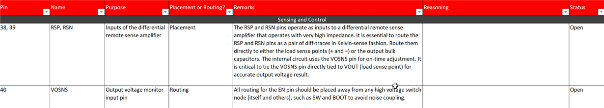

Do you have any guide material or advice for an optimal remote sense design for TPS548B22 in addition to the datasheet description?
(For example, about the best sensing point, recommended trace distance and so on)
Thanks in advance.
