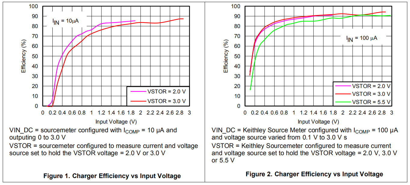

BQ25505: Can the charging efficiency diagram in the BQ25505 data sheet be simulated by software?
Part Number: BQ25505
The BQ25505 model is encrypted and cannot be simulated by Tina. Then how can the charging efficiency diagram of the charging management chip data manual be obtained? Can it be simulated by software (such as Cadence)?Besides building the test platform, can we use other software to simulate the charging efficiency diagram in the data manual?The following figure:
    I am not aware of a discontinuous mode efficiency model for a boost converter. It is possible but time consuming to build a DCM boost converter in a spice simulator and then average the voltage and currents of transient simulations at different dc operating points.
