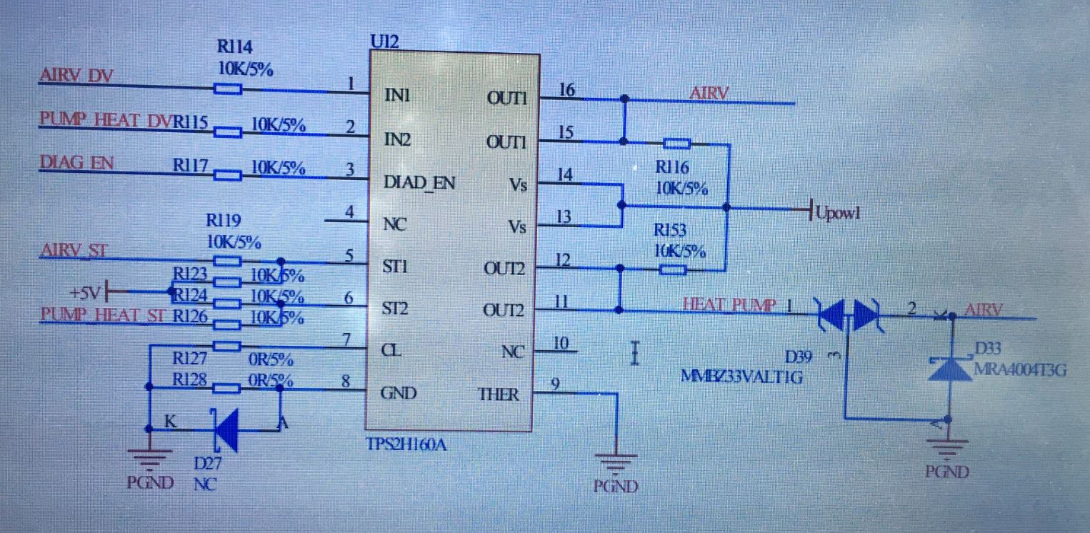

TPS4H160-Q1 has an EMI issue.  Could you comment on that and give us an advice? Thanks
Here are the action customer did:
  • total board IR test is Fail;
  • check the load of TPS4H160-Q1, the output current is fixed, output current is 1A;
  • Isolate TPS4H160-Q1(No power supply), IR test passed.

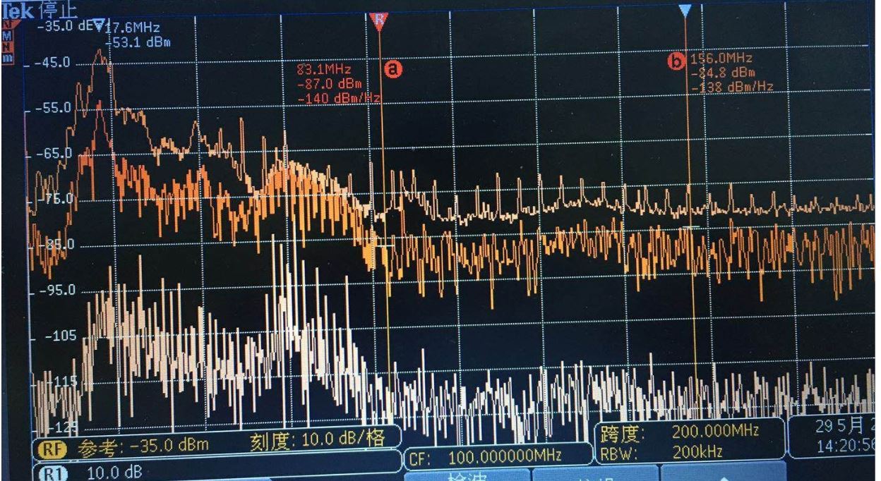

Here are the IR test result  for TPS4H160-Q1:
Use spectrum analyzer to test,  the output current is fixed (1A). The middle one is the result for IR:
No output current for TPS4H160
1A output current --- IR test result
