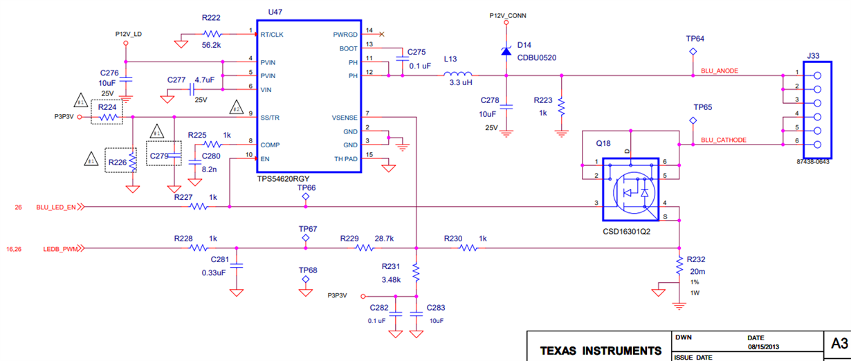

Hi team,
we recently discovered one faulty piece of TPS54821 after some time of operation. Behaviour is that DCDC does not work and PH pin seems to have 0.6Ohm to GND on un-powered board (same measurement on OK board shows >1k). High side switch seems to still be working (scope shows normal waveform to feed inductor from Vin). Thermal camera images shows very quick heat up of the chip upon power-up.  We are using mode of operation similar to this (constant current source based on PWM applied to VF pin, just DCDC PN is different):
Could you think if any mode of operation (enable, disable, ...) would case a stress on the circuit? We basically want to ensure that this was just a random part failure, not a design/software control issue.
