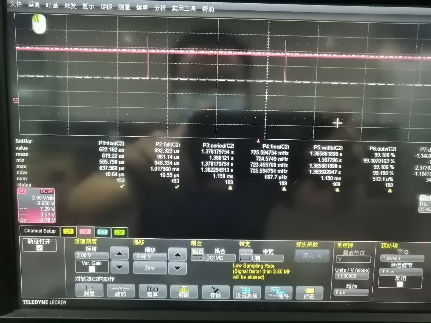

My customer is using BQ25790 to charge 2cell battery from 5V input.
When the battery is absent, we could see the system voltage is as below, it dips from 7V to 3V, period is 15ms, and the load on SYS pin is about 300mA.
We haven't changed the registers.
Then we cut all the load on SYS pin, and we get the waveform below: the period is still 15ms, but Vsys rises up. What may cause the issue?

  • Jeff,
    Yes when we disable charge the problem is solved.
    And the interval is around 1.5s not 15ms as I said before. 15ms refers to the overshoot pulse width
    But my question is:
    why SYSOVP is triggered every around 1.5s?
    In the datasheet, it says SYSOVP will force the converter to stop switching, then why the SYS pin can still be stable at around 8V most of the time?

  • Howard,
    When charging is enabled, after the battery voltage falls below BATUVLO (~2.5), the charger attempts to regulate the BATP pin to a fixed voltage (5V for 2S battery) for ~1.5 s to allow the pack protector FETs time to close.  After that time, the charger resumes normal charging.  In your plots, because there is no battery and only the minimum capacitance at BAT, the battery voltage overshoots after the 1.5 s, causing SYS to overshoot, hitting both OVP thesholds and turning off the BATFET and the converter.  If your customer cannot add the additional capacitance to BAT, please recommend that they use the /CE pin to disable charge when no battery is attached.
