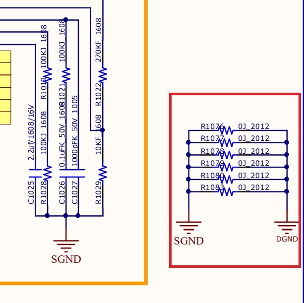

Could you review my schematic as attached file.

    Why two of your output capacitors are connected to DGND rather than SGND?

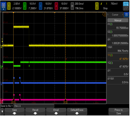

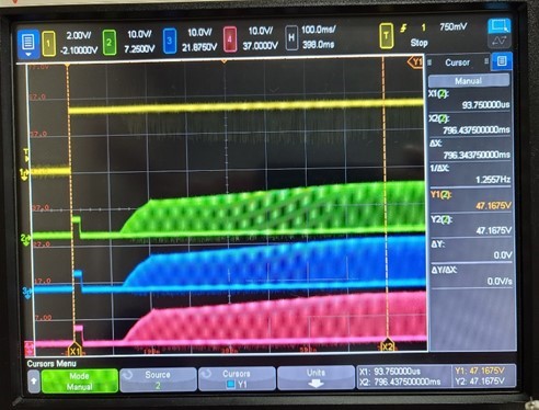

  • Hi Charles
     Waveform
    1. Normal operation at low temperature(Ch1 : EN , Ch2~4 : FB 3Ch)
    2. Low temperature Shutdown(Ch1 : EN, Ch2 : Fault, Ch3~4 : FB 2ch)
    DGND, SGND
    DGND & SGND are not separated.
  • Hi CHO,
    We recommend to connect these two output capacitor to SGND directly rather than through 0 ohm resistors.
    According to your waveforms, some faults happen in low temperature and your controller pull down the EN so that the device is shut down. So we need to find out which faults happen next step. Can you provide additional waveforms to find out the specific faults? For example, the output voltage, the input voltage, the node of SW, the current of inductor or the voltage of ISNS.
    We also have protection list at page 17 of datasheet and you can try to find some abnormal waveforms according to each item.

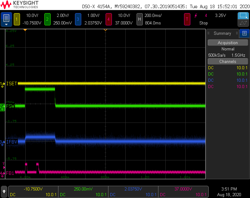

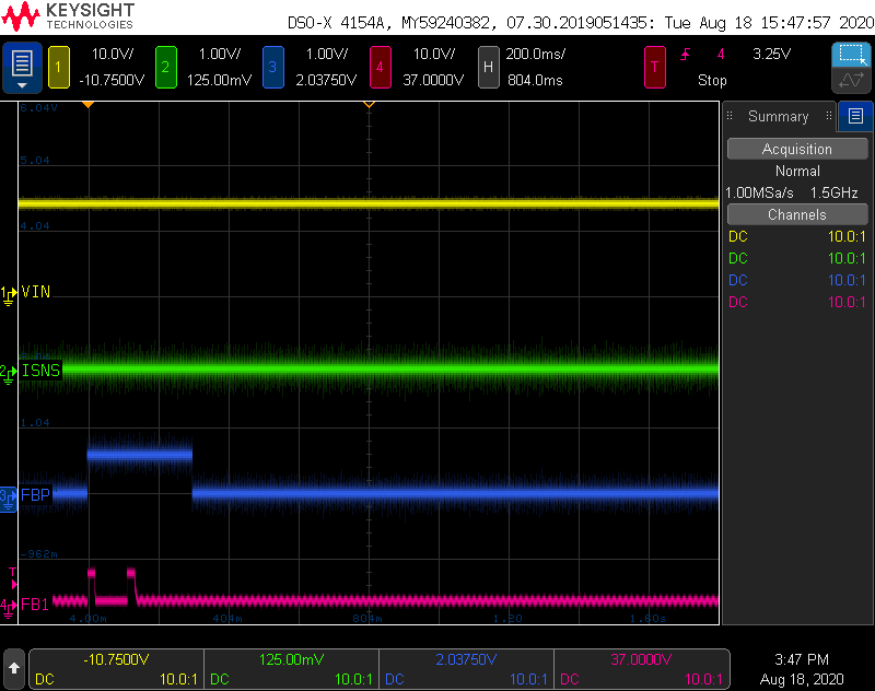

  • Waveform
    Ch1: VIN, Ch2: ISNS, Ch3: FBP, Ch4: FB1
    Ch1: ISET, Ch2: FSW, Ch3: IFBV, Ch4: FB1
  • Hi CHO,
    Sorry that I don't describe the waveform requirements clearly. Actually, I actually need the waveform at the following point when faults happen.

  • Hi Charles,
    Please review below answers and information.
    1. The input value of VIN in the previous mail is 13.5V and the Vout is 13V through D1(in the fault condition)
     7331.Wavefrom.zip
    2. Reviewed information

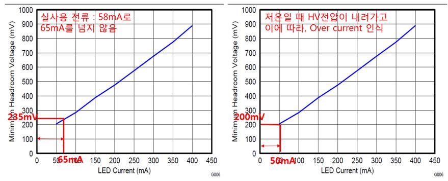

    a. ISET = 51K, it was set approximately 96mA(in Duty=100% condition) and actual usage is 58mA in duty=60% condition
    b. IFBV = 39K, VIFBV is set as 235mV
    c. In the below picture, Headroom Voltage is 235mV and assumed that it was in over current condition
    d. Over current Spec. was decreased in accordance that VIFBV voltage value was going down as a result of test(Temp.: 35, 0, -10 and -20)
    e. Thus, No boost up because it was recognized as over current in test temp. -20.
    f. Confirmed that the sample which was not boosted up in low temp was working in accordance with adjusting IFBV
    Actual current used: 58 mA to 65 mA                                                                     Low temperature: HV voltage goes down, over current recognition
    3. Requirement
    a. The difference of output voltage is around 40mV in IFBV according to temp., changes from 35 to -20.
         Could you please explain the reason why it has changes according to temp. of IFBV
         *Resistance error rate which was applied to samples is F grade.
    b. Please confirm whether we can use the values of schematic.

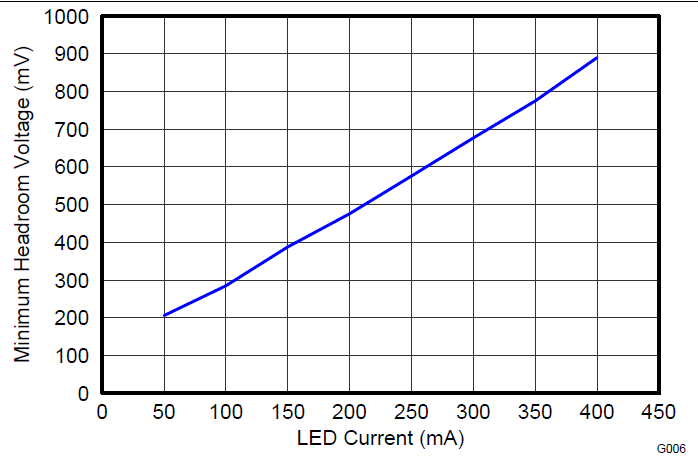

  • Hi CHO,
    You can see the minimum IFBV is 0.3V as provided in the datasheet. So you can set the IFBV higher to address this issue.
