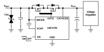

Dear TI Team
Our customer is considering the following circuit using the LM74700-Q1 and two NFETs
The data sheet shows the following circuit with one NFET
However, they want to design the circuit as shown above so that current flows through the parasitic diodes of the FET before the EN turns on and does not output to Vout.
What is the problem with designing a circuit with two NFETs as described above?
