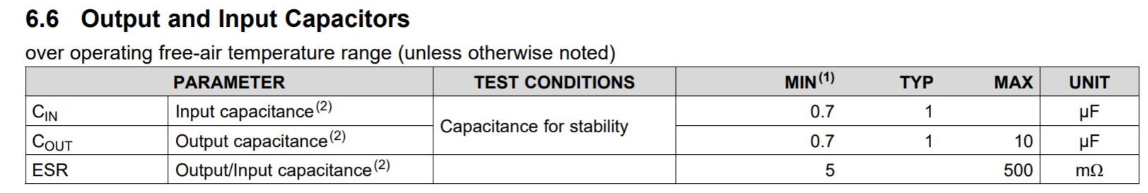

According to datasheet of LP5907, the maximum value output capacitor should less than 10uF. But customer wants to know what potential problems will happen if their output capacitor increase to 100uF?

Hi Stanley,
The LP5907 does not have a strong inrush control circuit. This is one of the many improvements that went into making the TPS7A20.
This is a pin to pin drop in and all package variants should RTM by the end of October/Early November 2020.
