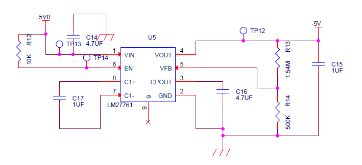

LM27761: -5V is not getting with +5V input
Part Number: LM27761
Other Parts Discussed in Thread: TPS63710
i'm using LM27761 to generate -5v output from +5v input. But i am not getting the proper output. Below is the schematic. May i know whether i need to change any of the capacitors value or is there any other issue.
Maximum input i can provide here is 5V or 12V. If it is not possible with LM27761 to generate -5V, kindly suggest with the alternate part.
