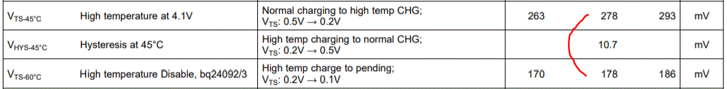

Hi team,
my customer is using BQ24092 in their design.  In the data sheet for the BQ24092 there’s a charge enable threshold across the TS resistor on the port. The line below shows 0V > 0.175V. Then in the min/nom/max it shows 80 88 96 mV. Could you confirm which is the threshold? They’re seeing around 170 to 180 mV some units are not turning on.
VTS-EN-10k Charge Enable Threshold, (10k NTC) VTS: 0V → 0.175V; 80 88 96 mV
V HYS below VTS-EN-10k to Disable, (10k TS-DIS_HYS-10k NTC) VTS: 0.125V → 0V; 12 mV
Thank you so much for your support!
