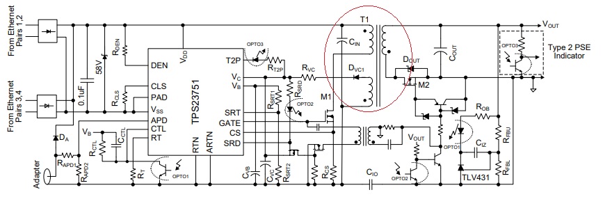

Hi Sir,
is there have calculate tool or data for T1 transformer?
need 12v/2A output specification.
    Please see the following paper for calculating components in a flyback:
    Alternatively, the following reference design meets your exact needs: https://www.ti.com/tool/PMP11254
    Either copy this design completely or use it as a guide. Thanks!
