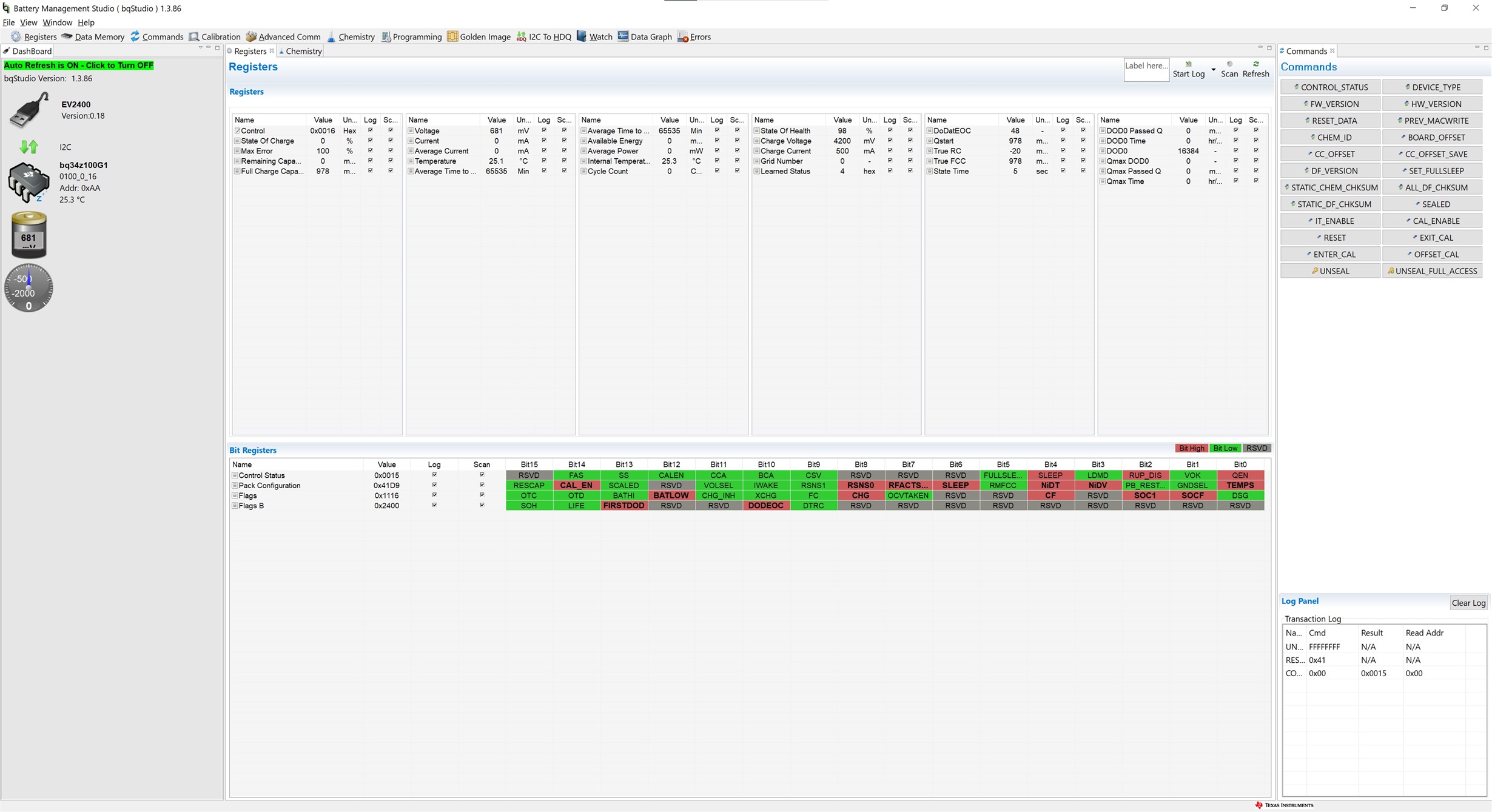

I'm trying to get this eval board working to evaluate this fuel gauge for our purposes.
I can communicate to the eval board using bqStudio and can read data out.  I have a 4S lithium ion battery connected across BAT+/- with the GND of the battery also connected to PACK-.
I have clicked on the UNSEAL_FULL_ACCESS command button and I believe that worked.  Both FAS and SS bits are green (LOW) in the control status register (see copied image below).
On the chemistry tab, I select ID 1630 (Lion-Polymer 4.4V) but when I try to program the chemistry by clicking the button at the bottom I get error 1470.
What is going on?
  • And here is the image, it showed it when I just pasted it in, but didn't keep it in the post...
  • I also notice that when I try to write the number of cells in series in the data flash tab, I get the error in red on the bottom status line, "A read of data written failed comparison".  So maybe that is indicative of a lower-level problem.
  • And I just updated the EV2400 to the latest firmware listed on its product page.  So that doesn't seem to be the problem as the error still occurs.

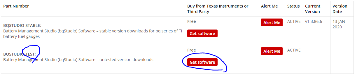

  • Hello James,
    In the test version of BQStudio some of the errors are resolved, I would try downloading the newer version to see if you still get these errors.
    Sincerely,
    Wyatt Keller
  • Hello Wyatt,
    I was trying to avoid this sort of "is it plugged in" type of first responses to save time and aggravation.  What gives you the idea that I'm running the "test" version?
    You can see from the image I posted that I'm already using bqStudio version 1.3.86.  According to the link you posted, that is the latest version to download.  Is that not the correct version?
    I also downloaded the latest chemistry files, now at version 823 as reported on the chemistry tab.
    James.

    From the Data Memory tab, I clicked on Import -> Import Defaults and then clicked on "Write_All".  After a short delay I got an error in red at the bottom of the screen, "Parameter not written. Class name Calibration, Subclass name Data, Parameter name CC Delta was written to data memory. A readback verification of this parameter failed."
    So it looks like the issue is that I can't write to flash at all.  I've seen other places where this can happen due to the "Flash Update OK Cell Volt" setting.  But I can't seem to write any flash values to change it.  I see that value is set to 2800mV and the GUI is reporting a voltage of 681mV, so maybe that is the problem.  But how do I fix it if I can't write the registers necessary to adjust the chip configuration?

  • Hello James,
    I apologize I think there was some miscommunication, I meant you should download the test version, it is newer than the version you had in the screenshot and it has bug fixes in it.
    Here's the one to download:
    flash update ok voltage could prevent you from writing, you would need to make sure the voltage is higher than the default during your gauge setup.
