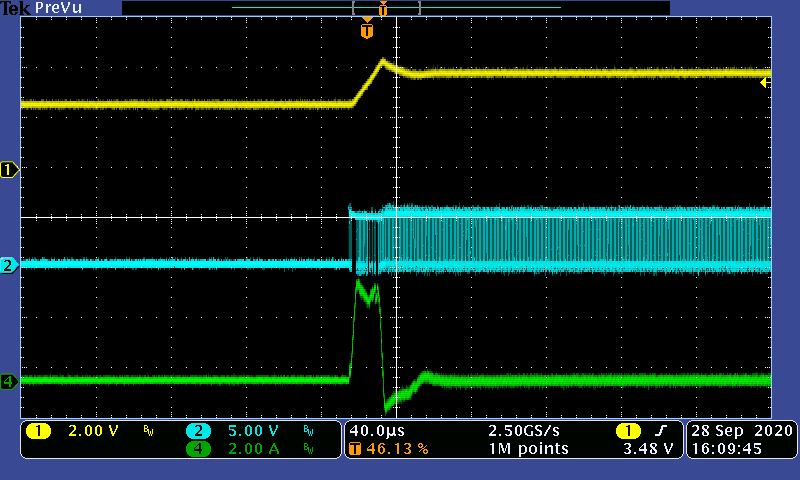

Hi Team,
Two quick questions on TPS63020.
1. Does TPS63020 support Pre-Bias Start up?
2. If No, What can I do to prevent a pre-bias situation?

Hi Jasper-san,
Thanks for you prompt response on this.
Sorry, I don't have such the information now, My customer just asked if the TPS63020 has pre-bias protection or not.
Can you explain to me how it behaves differently depending on the pre-bias situation?

Hi Takashi,
TPS63020 supports Pre-Bias Start up. And the higher the Pre-Bias voltage, the quicker the start-up. Ch1, Ch2 and Ch4 represent output voltage, SW voltage and inductor current respectively. And test condition is Vin=5V, Vo=3.8V, no load. The Pre-Bias voltages are 0 and 2.5V respectively.

Hi Takashi,
The waveforms I attached are not very proper and I have updated them.
