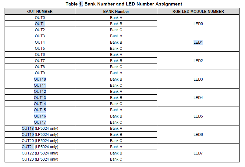

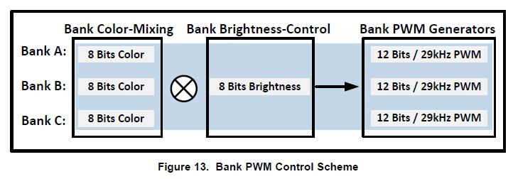

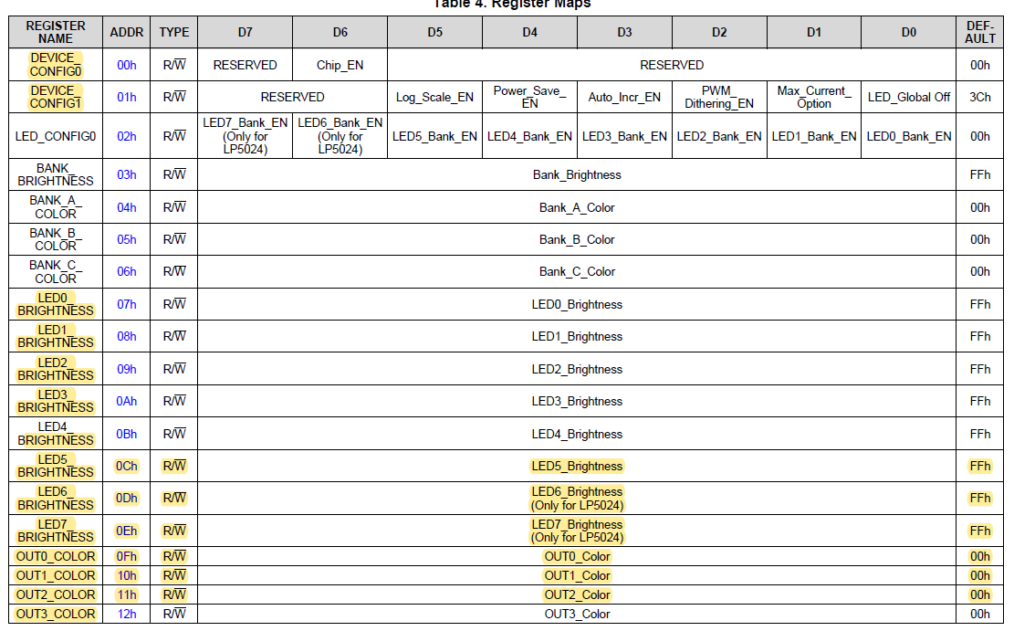

I understand that this device has 24 LEDs connected in parallel, and each 24 can be set separately with I2C, but is that correct?
Looking at Figure 13 below, it looks like Bank_A, Bank_B, and Bank_C are mixed with Bank Brightness-control to set Brightness.
This Bank Brightness-control seems to change the brightness of BANK_A / B / C (RGB) so that it becomes "white" or something and the brightness is corrected to become white. When that happens, it looks like each color cannot be set individually...
If it can be set individually, please tell me how to set it.
