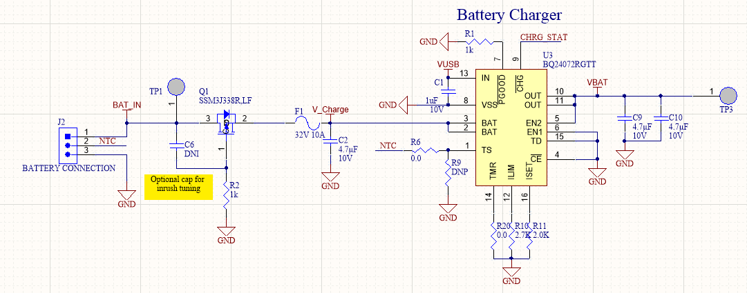

Our board is designed to keep the BQ24072RGTT in USB500 mode to allow charging of a LiPo battery when a USB cable is plugged in. We have seen 2 instances out of ~200 devices of this IC limiting the input current to 100mA. Both devices initially worked as designed and allowed for 500mA  input current to charge the battery, then they started limiting to 100mA input current. I see no issues with any of the input pin levels that would cause this USB100 mode.

    Just to narrow down the issue, would you be able to share the schematic? Is this issue repeatable? If it is, would you be able to capture a waveform at the INpin for voltage at the time of this occurring? Can you also check the voltages at the ENx pins?

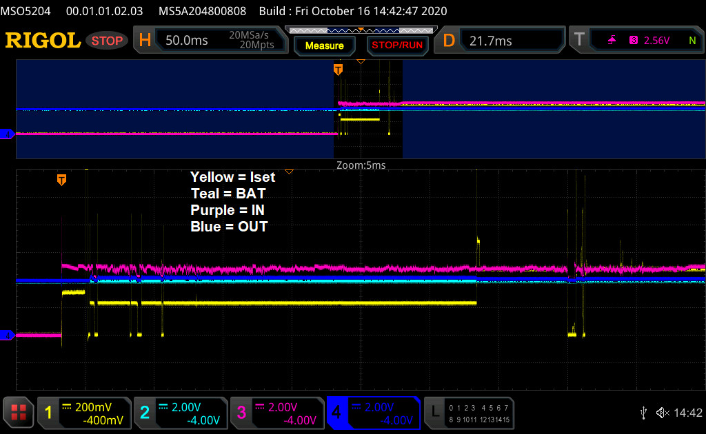

    See below for the schematic of the BQ24072, as well as a screen capture showing the USB plug in. The EN1 pin is tied directly to a GND plan, and the EN2 pin is tied directly to the OUT node.

  • Hi Eric,
    Thanks for the waveform. Would you be able to pull EN2 low and EN1 high? This is the configuration that is used to put the device in USB500 mode. The schematic is fine overall as the way you have it, it's allow for about 550mA input max.

    I am unable to toggle EN1 due to the board layout. This pin is connected to ground underneath the IC package. I can toggle EN2 from low to high (OUT) with no change in charging current.
    I am unable to measure the current at OUT due to the board layout, but currently the OUT pin is not connected to a load other than the filter caps shown in the schematic.

    Thanks for confirming the current, doesn't seem like changing the charge current would be helpful just yet. Would you be able to provide waveform with all of the following voltages at the following pins: IN, OUT, BAT, and ISET. Also, would you be able to switch the IC from a board where you see the issue to a board where the issue isn't seen?
  • Hey Anthony,
    See attached for waveforms from the failed board and from a good board.
    I cannot remove the IC easily as I don't have the appropriate equipment in house. For the first unit that displayed this failure, I had our CM replace the IC on the defective board. Once the IC was replaced, the defective board worked as designed, allowing 500mA charge current.
    All the best,
    Eric
    Failed Unit:
    Good Unit:

    Is the Battery connected to the output as mentioned in the schematic? As the board was working this wasn't a concern but if the EN2 pin is connected to the battery, this could be an issue of a misconfigured board if not damage.
  • Hey Anthony,
    The battery is not connected to the OUT of the IC. The OUT is connected to a node called VBAT (a carry over from a previous design iteration). From the schematic, the battery connects at J2, through the fuse F1, and connects to the BAT pins of the IC.
    EN2 is connected to the OUT pins of the IC, not the battery. I believe the schematic matches that provided on the BQ24072 datasheet.
