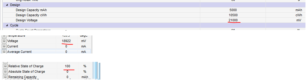

  • Another thing:
    Is the ROSC calculated based on Voltage value and Design Voltage setting?
    I do have:
    And ROSC is shown 100% - why is that?
    Also what could be the reason to have ASOC 0%? - I am after calibration and Data Flash Configuration Settings set, lerning cycle not done.
    Adam

  • Hello Adam,
    If you look at the Cell Currents vs the AvgCurrent, you will see we don't apply the scaling to cell currents.
    RSOC is computed based on RemCap/FCC which are simulations. Please refer to theory of impedance track applications note.
