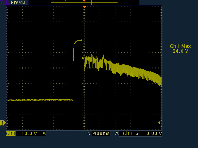

Hi Team,
The customer is testing the FB resister open protection. The vout will rise up to 54V. Is this the except behavior of our device?
As I know, the OVP of this device is sensing the feedback pin voltage. If the resister between FB pin and vout pin is opened, how did our device stop the PWM signal? Thank you.
The customer application condition and the FB OVP pin waveform are below.
Vin: 12~24V, Vout: 12V
