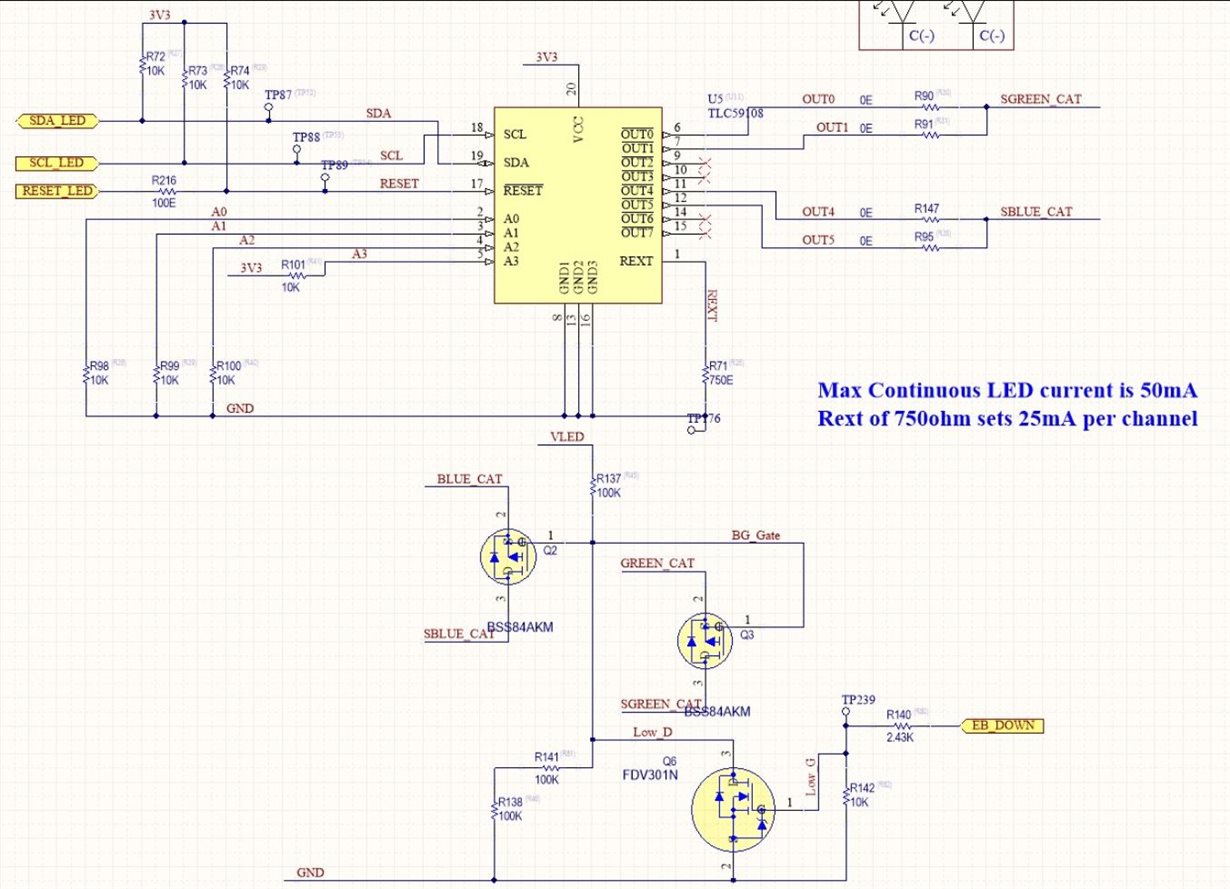

From my reading of the datasheet it is my understanding that no matter which Iout target is set, the threshold for open circuit detection is always half of the Iout target value. If target is 10mA, threshold is 5mA If target is 40mA, threshold is 20mA My question relates to the circuit image attached. Would, for any reason, the circuit of Q2, Q3, Q6 affect the constant current performance of the TLC59108? In our implementation the LEDs are illuminating, but the open circuit detection is not working correctly. We are normally showing the LEDs in open circuit, when the LEDs are illuminating.

    From my side, I think the Q2/Q3 should not impact output current, if BG_Gate set at proper voltage. As for Q6, I think it is used to control BG_Gate right? It should also not influence the outputs.

    You are right voltage on net BG_Gate is controlled by Q6.
    2 parallel channel outputs, with each channel driving 25mA is the example from the TLC59108 datasheet. Our LED is rated to 50mA, so it matched our requirements.

    We have a string of 3 LEDs in series. Their maximum forward voltage drop is 4V. Giving a combined maximum forward voltage drop of 12V. How much voltage overhead do we need to drive each channel to 25mA ?
    We calculate we have a minimum of 2.25 V above the combined maximum forward voltage drop. Is this enough?
    The yellow scope plot is taken at the cathode of the last LED in the string (of 3 LEDs in series) before the input to the TLC59108 at channels OUT0 & OUT1. This is at the net named SGREEN_CAT.
    The register setting is 05h in register 0Ch (both channels are fully ON)

    Sorry for late reply. You could refer Figure 2 in datasheet for the question how much voltage overhead do we need to drive each channel to 25mA. 1V dropped on output pin should be enough to drive 25mA current.
    This triangular wave voltage looks litter confused for me. Output of our device is current sink so that it generate current but not voltage. The triangular wave should be influenced by peripheral circuit. Does Q2 or Q3 have some regular on/off action?
  • Hi Hardy,
    The Gate of Q2 / Q3 is a steady voltage and both Q2 and Q3 are ON as expected.
