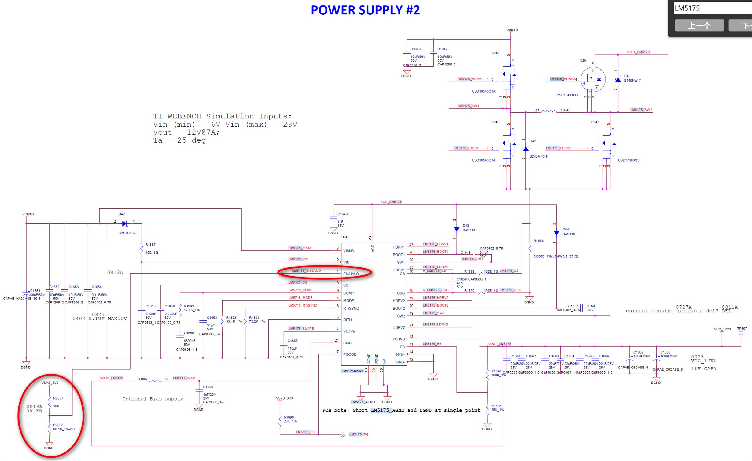

    The LM5175 circuit schematic is from the TDA4 Common Processor Board(CPB),  https://www.ti.com/tool/J721EXCPXEVM, just the EN pin of LM5175 connection is changed from input voltage to 5V in board.
    LM5175 circuit in our own TDA4 board.
    LM5175 circuit in our TDA4 EVM Common Processor Board(CPB).

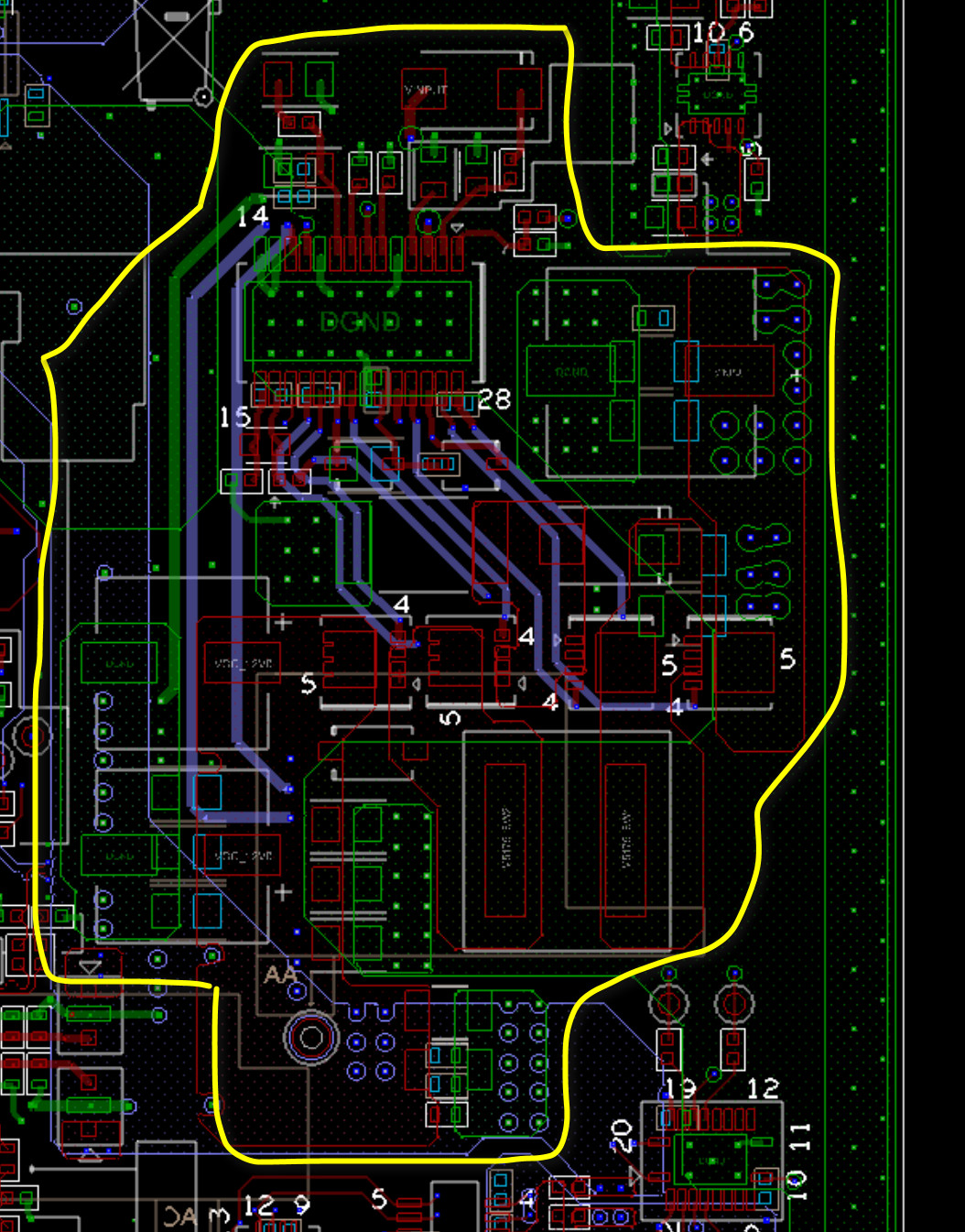

    the pcb layout picture with inner layer route is as follows:

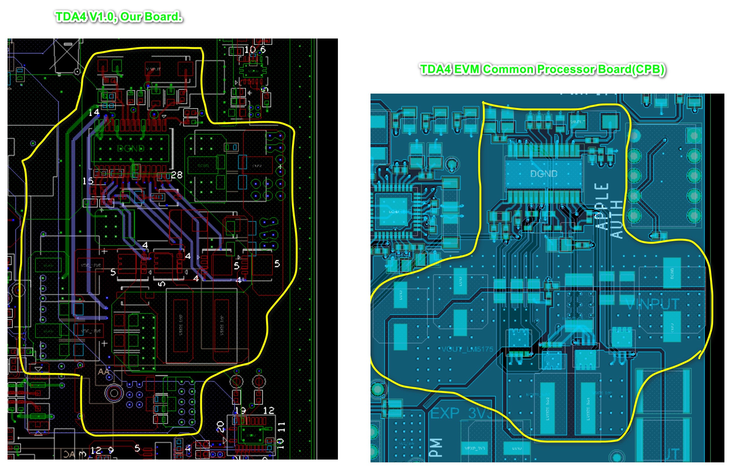

        May the NMOS be damaged due to PCB Layout? I also checked the differance between my PCB Layout and TDA4 Common Processor Board, as shown in the figure below.
        The major difference is GND VIA. TDA4 EVM CPB has some  GND VIAs between the traces LM5175_HDRV1,LM5175_SW1,LM5175_LDRV1 and LM5175_HDRV2,LM5175_SW2,LM5175_LDRV2 and CS.
        And TDA4 EVM CPB has more VIAs.
        Does the PCB Layout has so such a big impact? Will it cause NMOS damage?

  • Hello Hui Liu,
    In general the PCB layout of any power supply makes or breaks the converter. If the PCB layout is bad, a converter will not work properly, not work at all, get damaged or even get on fire. So yes, the PCB layout has a great influence on the operation of any converter. This is not specific to LM5175.
    I am sorry, but with the layout picture above, I am not able to check if the layout is good or has some issues.
    For the transistor damage, please check the following points in detail: SW1 and SW2 ringing. It is possible that noise during the switching operation causes undershoots and or overshoots that damage the switch or the controller.
    Another possible problem could be the temperature of the transistor. It is possible that it gets too hot.
