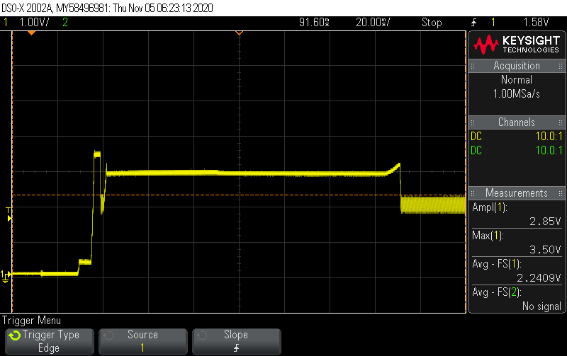

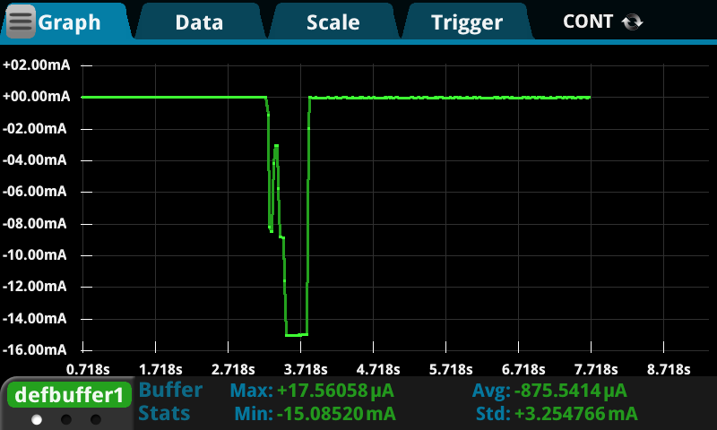

  • I have raised the precharge current to 20mA and it seems like around 3V we are able to unlock the PCM, but now I have observed a new issue. If the battery is under 2.9V, when we place it on the charger, the charge current goes up to 15mA and the voltage up to 3.5V, but after 550ms approximately, the voltage goes down to 1.9V and the current goes to 50uA, as you can see on the images below. Also, if the battery voltage is 2.9V, at charge it goes directly to 1.9V and 50uA. Any ideas what might cause this?

    It seems the protector is causing issues. Do you see the battery voltage increase and then drop in voltage while charging?
  • This is the battery voltage at the board (after the PCM) when the charger is connected.  As you can see the voltage was 0V because the PCM has disconnected the battery from the system. When the charger is connected it goes up and then after 140ma approx, it goes to 1.9V.
    The second figure is the current variation.
