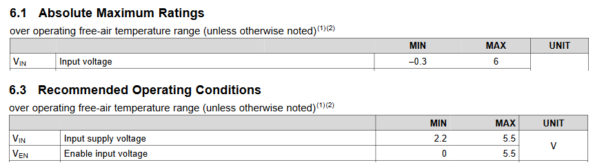

2.About LP5907MFX-3.0 / NOPB Please tell me the range of input voltage and output voltage.

    The part number provided (LP5907MFX-3.0 / NOPB) is a fixed 3V output with steady state tolerances of +/- 2%. As shown below the maximum Vin is 6V and the recommended max is 5.5V.
