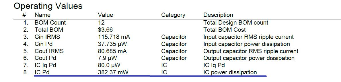

We'd like to know how to calculate the IC's power dissipation correctly. In the WEBENCH result, there is a IC Pd shown. how to calculate it? Could you offer formula of the power dissipation including bias power, FET switching, fixed power losses and others...etc! Very thanks.

    The simplest way to get a good approximation of buck IC power dissipation would be the following:
    • efficiency (%) = (Pout/Pin)
    • Pout is determined by your Vout Iout requirements and efficiency can be found in the device datasheet for a given operating condition
    • Solve for Pin
    • Pout - Pin = IC dissipated power + inductor power dissipation + input capacitor power dissipation + output capacitor dissipation + feedback resistor power + conduction losses through the traces + other
      • The losses here are dominated by the IC dissipated power and inductor power dissipation. Inductor power = (Iout)^2 * DCR gives a reasonable approximation
      • After solving for this you can solve for IC dissipated power
      The method I've outlined is rather simplified but can still offer a good approximation of IC power dissipation, if a more accurate model is needed, then the article is your best bet.
