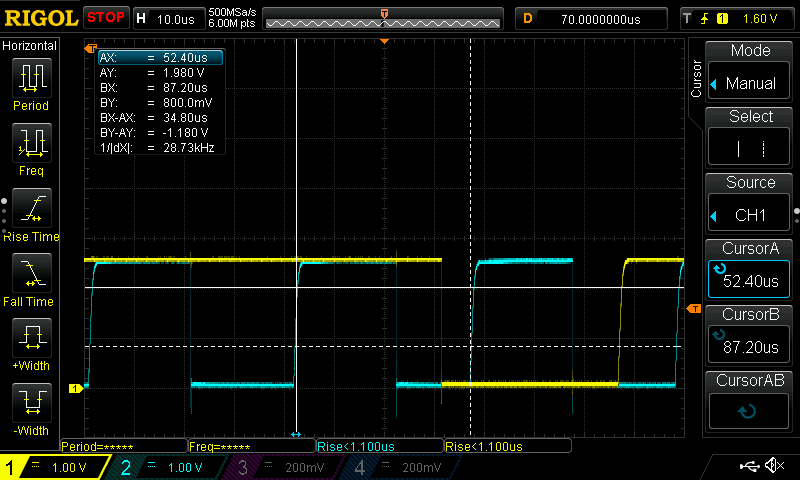

  • Hello Ning,
    The battery protection circuit was not active during this scenario, the protection circuit was functioning normally.
    Could you please let me know if there is a mode which could turn either Q1 or Q2 OFF (Please find the attached snippet of Battery charger BQ24190 block diagram)
    Is there a test mode that could be set un expectedly that could cause Q1 or Q2 to be turned OFF?
    Would a signal on the OTG cause the device to malfunction?
    Observation:
    The system side I2C interface for BQ27531 (Fuel Gauge) has two masters
    1. MCU operating and 100KHz
    2. SOM module operating at 400KHz
    The B side I2C interface between BQ27531 and BQ24190 was found to be operating at 28KHz is that expected.
    Please find the attached scope captures for the B-Side I2C interface between BQ27531 and BQ24190.
    Best Regards
    Krishna
