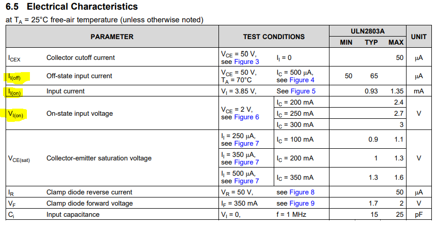

Our customer wants to use the ULN2803A ans they need the exact Logic voltage levels. Can you please help us provide logic voltage levels (VIH,VIL,VOH,VOL) for ULN2803A?

  • Hi Cedrik,
    ULN2803a is an anlog device, so there really isn't a clearly defined ON that is black and white as it is a Darlington pair. Current is gained.
    There is some definitions about Von , Ioff/ on where we define where the darlington pair to OFF/ON based on output current, but they are not equivalent to VIL/VIH/VOL/ etc.
