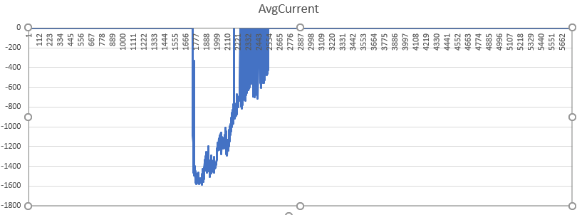

    I have re-created the issue and collected logs with EVM EV2400   and  BQ studio during host CPU shutdown for few hours .
    Device kept shutdown at 32% and after 6 hours , state of charge jumped to 61%  . Kindly have look on .csv file attached .
    PSG_4
    BQ27542_G1_ jumping_after Shutdown.zip
    Can you also share your .gg file? Is your load very dynamic? I see the average current looks pulsed.

    Actually  System  load is not dynamic and it is around 350mA in normal working mode . The load current  during system shutdown in around 375uA (micro Amp) .   The logs  are taken during  system  shutdown (after  disconnected I2C line from host CPU then connected to EV2400) .
    Log starts at 31% (battery voltage = 3.767V) and log end after 6 hours with battery capacity =61% ( battery voltage =3.760V) . The voltage difference between both log points are  less (only 7mV) and hence actual load during shutdown also  very less.

    What was the log shared earlier? It looks like the current jumps from 0 to 600-800mA from the log I am looking at:

  • Hi Wyatt Keller ,
    The log had taken when system (host CPU) was at shutdown stage  and  to show the  increase in battery capacity  during shutdown (original issue under discussion) .
    After  system shutdown , I2C lines are  removed from host and connected to EV2400 and collected log using BQ studio  for 6 hours. Log starts at 31% (battery voltage = 3.767V) and log end after 6 hours with battery capacity =61% ( battery voltage =3.760V) . it is clear that there no voltage difference after 6 hours and hence no current consumption . Voltages are measured with multimeter.
    I am not understanding current jumps from 0 to 600-800mA  as there is no voltage reduction at battery terminals after 6 hours .

    I'm still not quite sure what the log is showing, there is current flowing according to the gauge so the system isn't shutdown.
    Usually we see SOC jumps like this when the design capacity is wrong or the steps weren't completed successfully:
    Find the chem ID using GPCCHEM tool.
    Set the parameters for your application (design capacity, current thresholds)
    Run a learning cycle for Qmax and Ra to update.
    Then accurate gauging can be achieved. It looks like the gauge thinks the battery has less capacity than it really does and corrects it when the system is in shutdown.

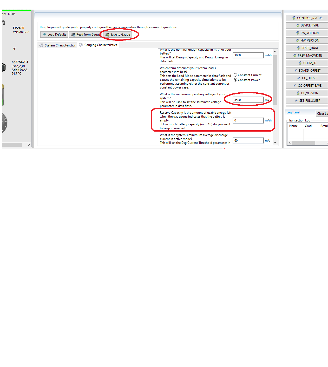

  • Hi Wyatt Keller,
    I am doing calibration again with  Chem ID 2066  using fuel gauge  BQ27542.  My battery nominal design capacity is 3000mAh and  system minimum operating voltage is 3.5V  . First flashed Chem ID 2066 to BQ27542 and then done calibration for  CC offset and voltage .
     I have below doubt about Parameter Q&A  settings .
    1. Is  " save to gauge " is required  after   configuring System characteristics and Gauge  characteristics in Parameter Q&A  tab in  BQ studio tool  ?   This feature is  not supporting in my BQ  tool .
    2. Is it possible to enter "reserve capacity " as 0 mAh (zero) if  I want to declare battery is  empty at 3.5V  ( system minimum operating voltage is 3.5V) . If value must be non -zero  , how to find reserve capacity ?
    System characteristics and Gauge  characteristics in Parameter Q&A  tab  is attached for reference .
    PSG_4
    You can configure the reserve capacity for the amount of capacity you want remaining when the gauge reports 0% SOC.
    You will need to save the calibration data to the gauge, the calibration values in data memory will change if the calibration was successful. You can read the data memory after calibration and should see the values change from default.

    What I understood from your reply is , there is no need to save "parameter Q&A" as it is before doing calibration.  Calibration values in data memory will change if the calibration is  successful. I can read  the data memory after calibration and should see the values change from default
    Regarding reserved capacity  configuration , my system  minimum voltage is 3.5V .There will be  appx. 300mAh charge will be kept as not using  when fuel gauge report as 0% capacity  at 35.V .  System will shutdown at 3.5V and  this 300mAh is not useful.
    So let me know what should be value I have to  enter as reserve capacity . Is it 300mAh or 0mAh ?
    PSG_4
    I'm not sure I understand what the Q&A question is. For calibration use the EVM user's guide to find the calibration values for your system. You can average 20-30 boards calibration data for the final production golden image to program other gauges.
    If your final voltage is 3.5V you should set your terminate voltage to 3.5V so the gauge uses that voltage to predict 0% SOC.
    Read through section 6.1 Introduction to Impedance Track in the TRM for information regarding the terminate voltage: www.ti.com/.../sluub65a.pdf

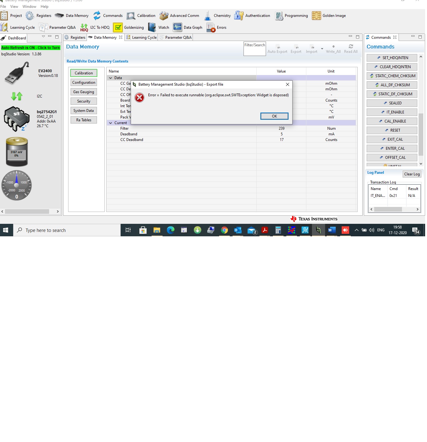

  • Hi Wyatt Keller ,
    I have finished successful learning cycle with BQ studio tool V 1.3.86  but facing issue while exporting data memory.
    While do export getting  error " Failed to execute runnable(org.eclipse.swt.SWTException:Widget is disposed ". Image attached for your reference .
    Could you help me to rectify this issue on urgent basis ? If suggesting for install different tool version , then how to save all data for learning cycle which is running from last 30 hours
    Can we do create golden file without exporting/importing  data memory  ?
    PSG_4
    Can you export the .gg file or the .srec? either will work to transfer the data from the learning cycle.
