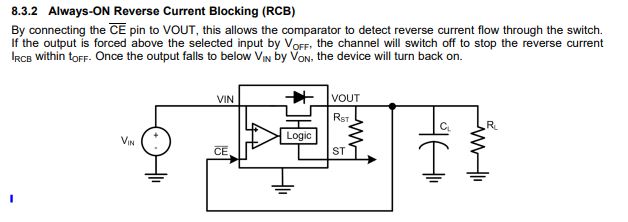

One Question, using the LM66100 in RCB,
Suppose that the Vin is a coin battery and the Vout is connected to a wireless MCU1 like CC2652 that reads sensor data and transmitted it to another wireless MCU2.
I want that when the battery is disconnected the ST pin gives that information to the MCU1 (interrupts), and the MCU1 has time to communicate ("POWER LOSS") to MCU2 before the power on MCU1 drops out.
Could I use the circuit above to do that. (The CL capacitor 220uf).
