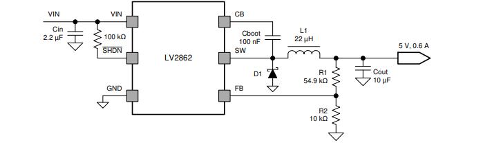

  • Thanks. I am preparing the setup to measure the SW Node frequency. Mean time can you suggest some alternate parts which suits for 5mA current
    Can I use the part LV2862XLVDDCR. It works in ECO mode at low current. Do you see any possibility of humming sound or EMI Related issue with this part when the output is loaded with 5ma or less current. Please confirm.
    I am going to use the below schematics for my Design with couple of bulk caps at the input & Output side. Hope this will works fine.
    Anuraj NK
  • Hi Anuraj,
    I think you first need to measure the SW node and increase the current to verify that ECO mode operation is the causing the noise.
    Since the LV2862 device also has ECO mode, it may also produce this noise.
