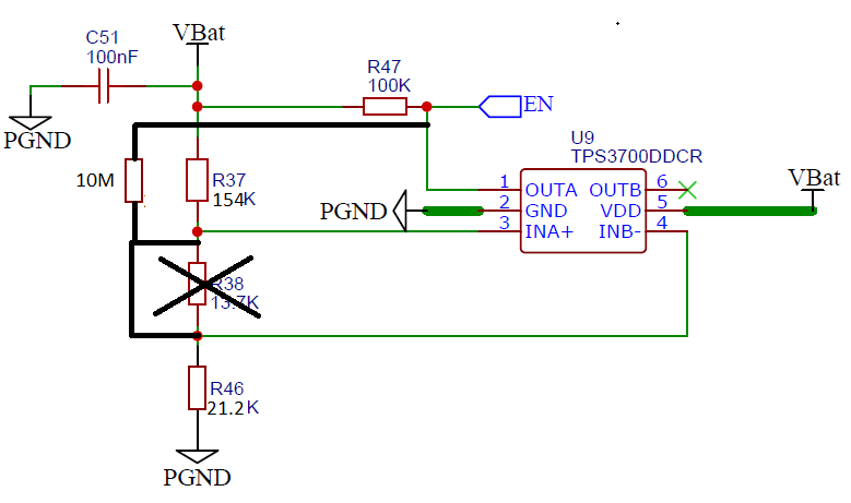

I was looking at the feasibility of adding a larger hysteresis to the suggested design found in the TPS3700EVM-114 with a gap of 0.1 V and how I would be able to do that with the schematic given below:
Schematic_New Project_2020-12-15_10-55-20.pdf
What should I change if I wanted to have my low voltage cutoff to be at 3.2 V and allow the ceiling of my hysteresis be at 3.3 V?? I have already taken a look at the guides posted by texas instruments online and I just was not sure how I would implement that in schematic above.

    See below.  The resistors will give you hysteresis for for INA+ and INB-.  You would need to size the resistors to give you the hysteresis you need.  Also, you can read up on "case 2" in the app note on how to add hysteresis to a voltage supervisor.:
    www.ti.com/.../slva360.pdf

  • Hi Abe,
    This is what I would try:
    R1 = 154K
    R2 = 21.2K
    Rp = 10M
    V+ = 3.31V (going up)
    V- = 3.21V (coming down)
    HYS = 100mV
    I hope this answers your question.
    Ben

  • Based on the schematic above, would I be able just to leave R38 and R46 as they are and swap out R37 with a 560 kOhm resistor and add a RH resistor of 1Mohm??
    The R37 value was calculated with equation (1) from the document you sent me and was found to be 560.648kOhm but the only resistors available to me from my supplier is 560 and 562 kOhm. I was also looking at keeping Rp as 100kOhm. I am trying to add the right 100mv hysteresis by altering the R1 value and adding a Rh resistor between INA+ and OUTA.

    I changed the resistor ratio that you had because the feedback resistor that is creating the hysteresis is quite large (>35Mohms).  For your application, you only need one resistor to create the hysteresis you need to meet your application goal.  Hopefully, these values will achieve your design goals.  See below.
  • Hi Abe,
    Since your schematic does not use the output OUTB, you dont need to have R38.  You can remove R38 and place a 0ohm resistor in its place.  For R46, you will need to replace it with a resistor equivalent of something near 21.2Kohms.  R37 would need to be swapped out for a resistor value of 154Kohms.  The hysteresis resistor will be 10Mohms.  See the schematic that I have provided.  THis setup will give you the 100mV of hysteresis and meet your voltage thresholds (3.31V going up and 3.21V coming down).
    Ben

  • Hi Abe,
    I really hope things will work out for you.  You can use a 10K and a 11.2K for in place of R38 and R46.

  • Hello Ben,
    I have made the changes and I've noticed that I'm still facing the same issues I had before in addition to it happening over a larger range. It seems that the comparator has no issue cutting off the voltage at voltages less than 3.2 V. The issue comes as the battery is being charged. I have also noticed that when I temporarily (for 10 seconds) trigger the LEDs at a battery voltage of 3.7 V while I am consistently drawing 1 A from my continuous load, the lights remain on and causes a voltage drop to 3.2V and remains this way (since the microcontroller unit needs at least 4.5 V to function and control the lights) till my battery capacity decreases to a value low enough to disable the converter.
    I'm confused as to whether my issues are stemming from my 5 V converter or comparator VOUTA pin as each works well individually just not together.

  • Hi Abe,
    First off, are the new resistor values giving you the correct output signal from the TPS3700?  Is OUTA going high around 3.3V and going low around 3.2V?
    Is the output of the TPS3700 goes to the EN input of the DC/DC converter?
    I am not sure about your application but it seems the TPS3700 is giving the correct hysteresis (100mV).
    Ben
  • Yes they are giving me correct values for OUTA at 3.3 V & 3.2 V.
    Yes the output is connected to the EN input of the DC/Dc converter.
    The output voltage of the converter after the enable goes high is not what I expected as it is not strictly 5V and above. It rather gives 3.8 V and 4.2 V as its charging up until my battery voltage is charged up to a higher arbitrary value which gives 5V. This would not be an issue if the Enable is not connected to  my comparator
