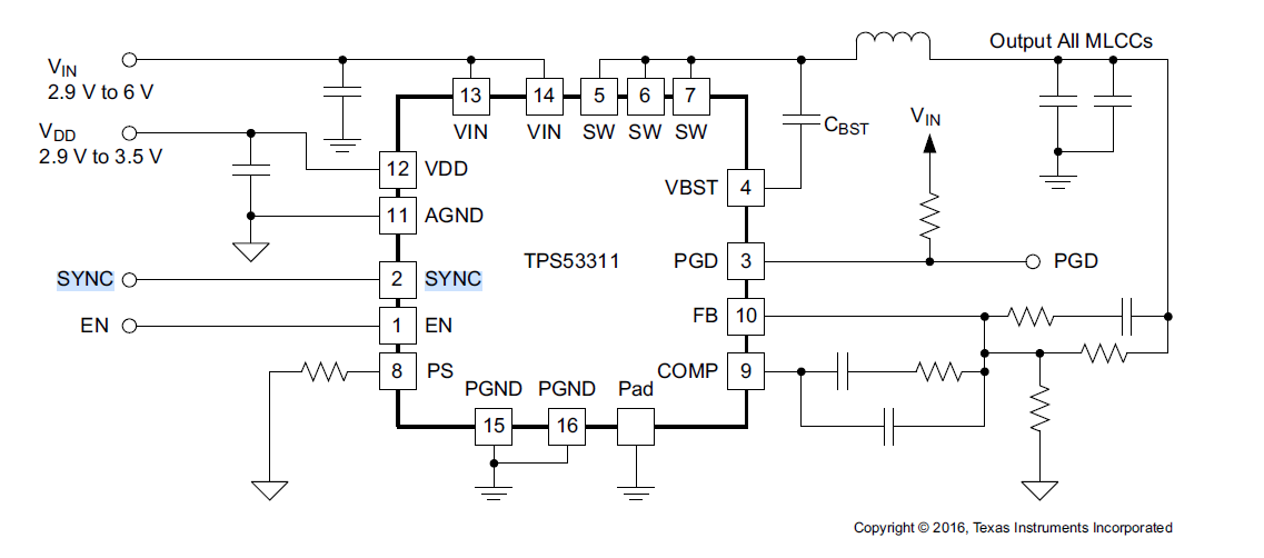

Hi team,
How to deal with the unused SYNC pin of TPS53311?
Thanks!
Reagan
Hello Reagan,
If you only plan to use a single TPS53311, you can leave the SYNC pin floating if unused.
The device will operate and regulate using its own internal clock.
