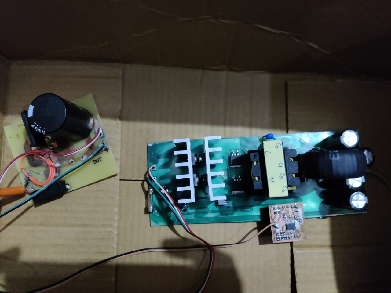

we made the prototype in house.
and then we tried testing the board.
When we tested the board, the output showed 95mV and then blew up the component.
When we checked, we found out that the Driver IC got damaged.

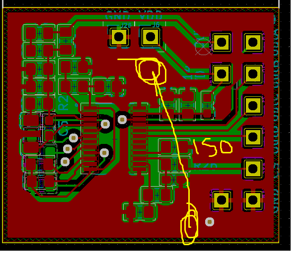

We checked the controller board and found that the ground pin of the UCC28950 is completely floating. ( image below)

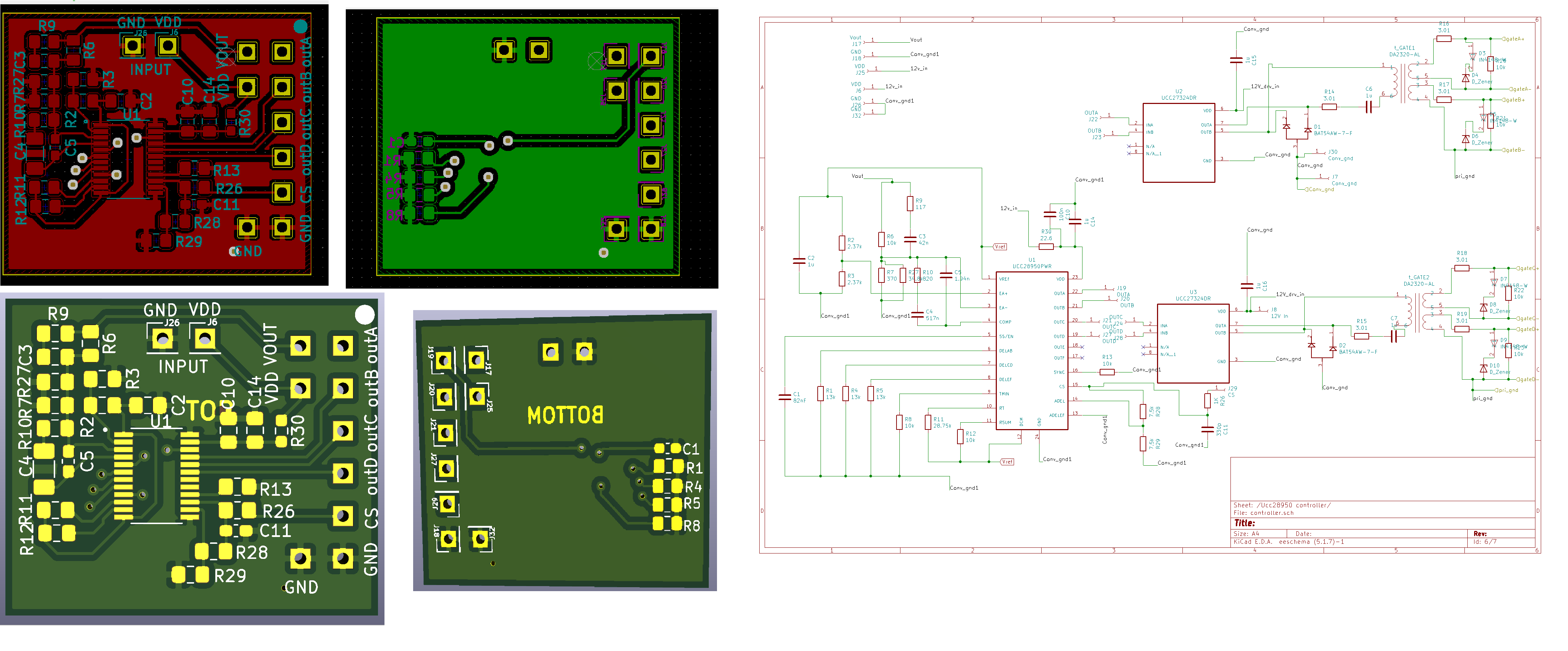

I am attaching the Schematic and the layout for the controller and the mainboard.
We revied the main board and found out that the out A on the main board trace was cut and the CS pin on the main board trace was cut.

    I looked at the pictures you have sent and cannot see how those planes are floating.  This is double sided board with plated through holes.  There are three through hle mounting locations that are shorting these planes.
    You have made your own boards and even it you did not use through hole plating.  It looks like these are soldered with a wire going through and should be shorted as well.
    The layout you showing was used on the original UCC28950 EVM that was designed in 2010 and no one has reported issues with grounding.  You can find a find the latest user's guide for the EVM at the following link.  There are waveforms in this user's guide that can help you evaluate the design better.  You might consider ordering and evaluating this design to help better understand the operation of the UCC28950.  This design can also be modified to support your current design as well, to rule out layout issues.
    What causes FET drivers and FET to become damaged is current and/or voltage maximum ratings to be exceeded.  This will cause electrical overstress and cause the design to become damaged.
