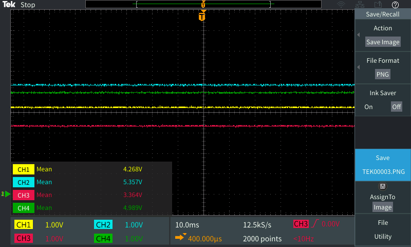

  • Hey Anthony,
    From the customer-
    The voltage measured in previous email is VCHRG in the schematic( Pin 6 Vin of charging IC). The battery voltage is around 4.2V when I took the data. And, there are two capacitors (10uF) parallel to the battery, but they are not showed in the charging circuit.
    Today I take the data again by CRO. Please find the below data for your reference.
    (refer to TEK00002 & TEK00003)
    Voltage of Battery just before charging (Pin2) (CH1)
    Voltage of Battery
    (Pin2) (CH1)
    Voltage of Vin
    (Pin6) (CH2)
    Voltage of VCHRG
    (Pin3) (CH3)
    Voltage of TS
    (Pin 1) (CH4)
    Charging current after CHG terminal turn to high
    4.220V
    4.268V
    5.357V
    3.364V
    4.989V
    ~185mA

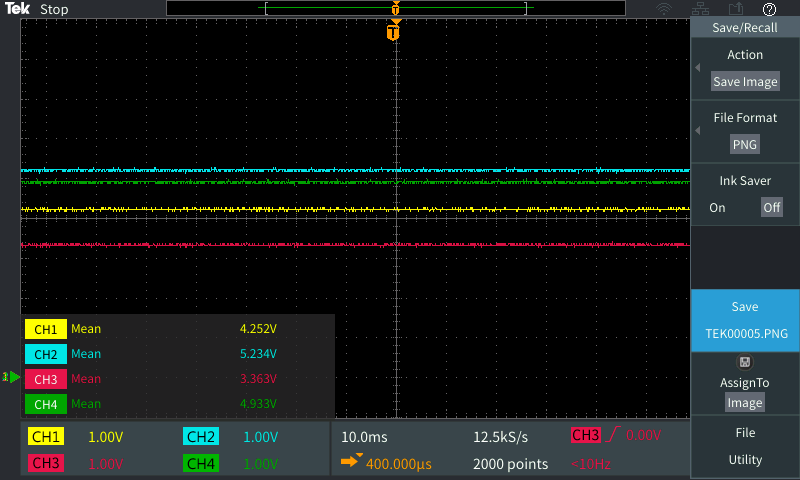

    (refer to TEK00004 & TEK00005)
    Voltage of Battery
    (Pin2) (CH1)
    Voltage of Vin
    (Pin6) (CH2)
    Voltage of VCHRG
    (Pin3) (CH3)
    Voltage of TS
    (Pin 1) (CH4)
    4.247V
    4.252V
    5.234V
    3.363V
    4.933V
    34mA

  • Hi Lauren,
    If the battery is close to 4.2V, the charge current will begin to taper to the termination current which is 10% at 5V which is expected behavior. I wouldn't expect the termination current to change with VIN and the fact that it is increasing with VIN is a concern.
    I also notice that the TS voltage is oddly high despite a 10k resistor. This may be putting it in TTDM mode and disabling termination but wouldn't explain the change in current with changing VIN. This voltage should be about 0.5V with a 10k resistor. Can we check that the IC is soldered properly?
  • Hey Anthony,
    Their comments-
    Sorry! The voltage of TS measured before was wrong because I monitored it with the wrong place. The voltage of TS should be around 0.5V. Please find the attached wavefront for your reference.
