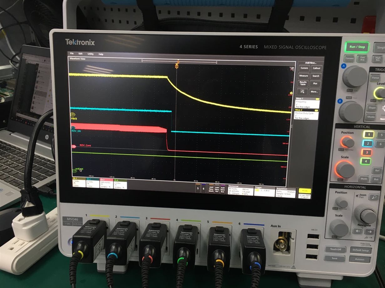

I setting the rail#2 ROV_Core Enable (Pin17 GPIO5) is follow rail#1 (P3V3) to output high.
But now when rail#1(P3V3) is powered down then up, the rail#2  ROV_Core enable pin is keep low.
Note: UCD90120A VCC is alive during the power cycle.
I insert my code & issue waveform

    Have you set the rail#2 as fault shutdown slave of rail#3? rail#2 will not follow#rail3 unless it has been set.
    setting sequencing on/off dependencies does not shutdown rail#2 when rail#3 is off.
    Please review the sequencing and fault shutdown slides in the attachment.

  • Hi yihe
    I solve my question by change rail#1 Fault shuts down due to fault ,turn off these rail as well setting : Close AVS_COE(rail#12)
    Becauce our new design unuse AVS_CORE this power. So we try to close this setting base on code : UCD90120A 2.3.4.0 Address 52 Project File_NCP1-1_PVT_R03_20201202.xml
    And then we can solve rail#2  ROV_Core enable pin is keep low issue. But I did not know this change will solve it?

  • Hi
    I am not quite clear about what you want to achieve here.
    The enable of Rail#2 is ACTIVE HIGH. if its stays at low, there are two possibilities; 1. the PMBUS_CTRL signal is not asserted/3V3 is not above its POWER_GOD threshold.2. rail#2 was shutdown due to fault.
    if rail#2's enable never goes high after the board is up, you have to look PMBUS_CTRL and rail#1
    If rail2's enable changes from high to low at some point, it is due to a fault. but looking your project file, I do not see there is any fault response set.
    So you may need check PMBUS_CTRL and rail#1's voltage.
