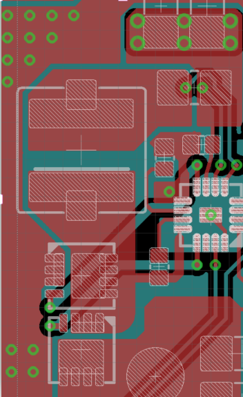

I used Webench and the TPS4306x design spreadsheet for guidance. I did what I think is a good layout (not my first switcher layout).
Switch node, current sense, hi drive and lo drive all scope good, up to ~66% output anyway. Vin, Vcc are stable.
But I only get 88% efficiency and some sub-harmonics above 66% output.
The harmonics goes away if I add output capacitance. But the efficiency does not improve. The resulting heat is a show-stopper for the application.

4-layer board with tight layout, tight loops for high and low drives.

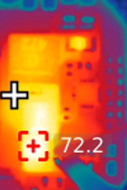

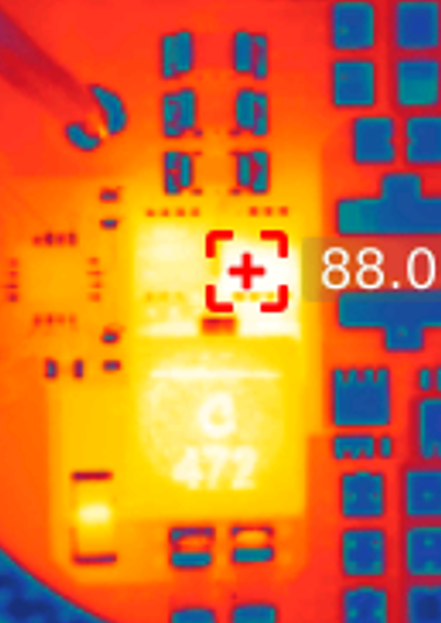

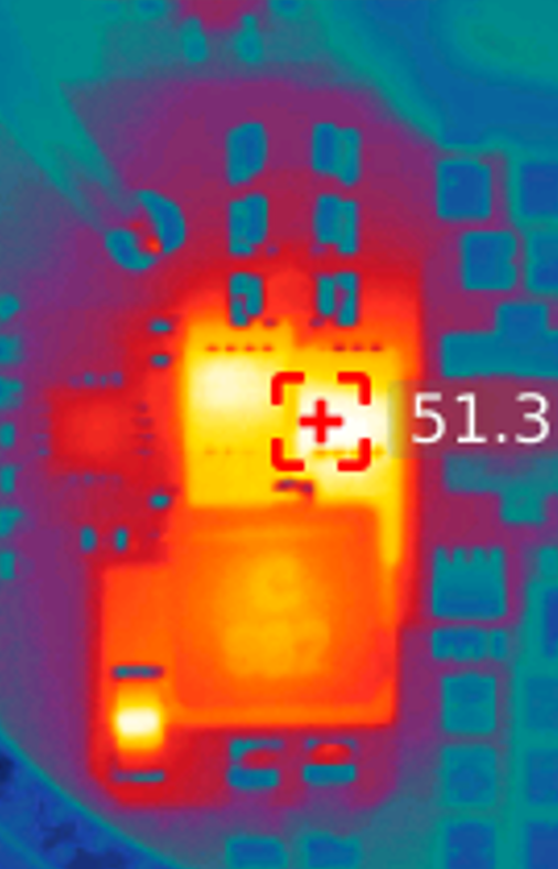

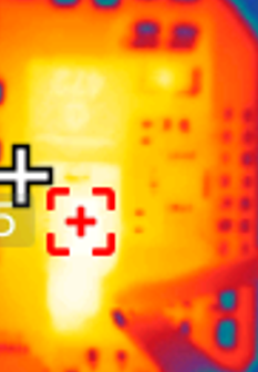

    There are some thermal images below. At <66% loading QH seems to run the hottest, at full load it is QL.
    The design spreadsheet gives these worst case estimates:
    L: 454 mW
    QL/Q11: 314 mW
    QH/Q12: 621 mW, of which 511 mW is 'dead time losses'
    So expecting about 1.5 W total losses with 55 W output. Lets say 2 W with Rsense and copper losses added. Actual total loss is 7.45 W.

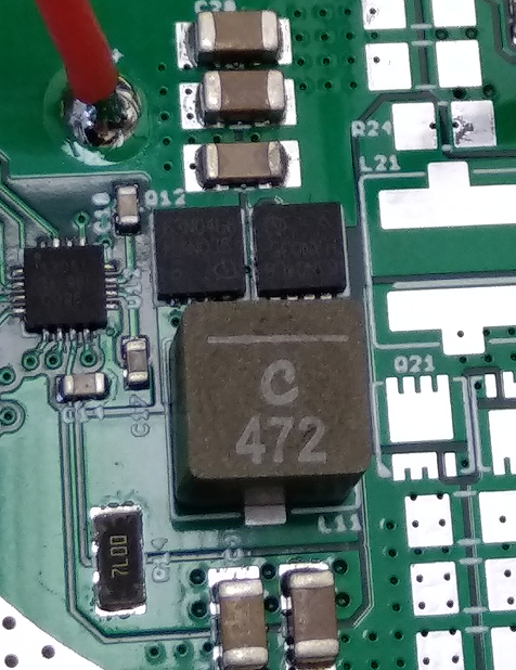

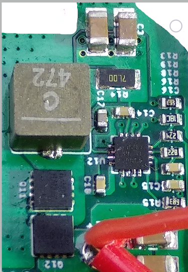

    Input is from the 6x0.5 mm vias at the top capacitor pair. Output is at the red wire.
    Layer 2 is mostly AGND, except below the inductor and switching node.
    Layer 3 is mostly PGND. It has the FET drive lines, current sense lines, TPS enable from a 5 V MCU, AGND below the TPS.
    Bottom layer is PGND and Vin.
    No blind vias. Board is only 1 oz currently, final board will have 2 oz copper. But I do not measure any significant voltage drops.
    Top layer and layer 3:
    A few seconds after loading at 2 A (original Cout, so still with the sub-harmonics on the switching node):
    1 minute after loading at 2 A, hot-spot is QL, reading (off screen) is 106.5 C:

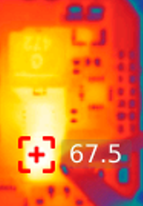

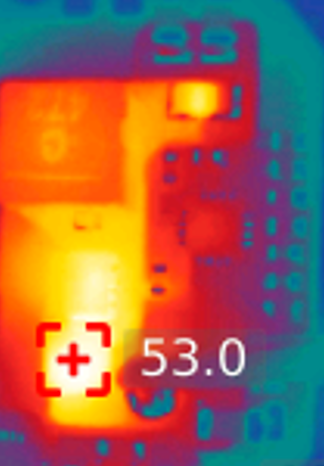

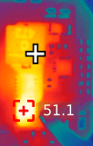

    At 1 A loading QH takes the lead. (No sub-harmonics at 1 A). A few seconds after power-up:
    1 A loading, stable operation:

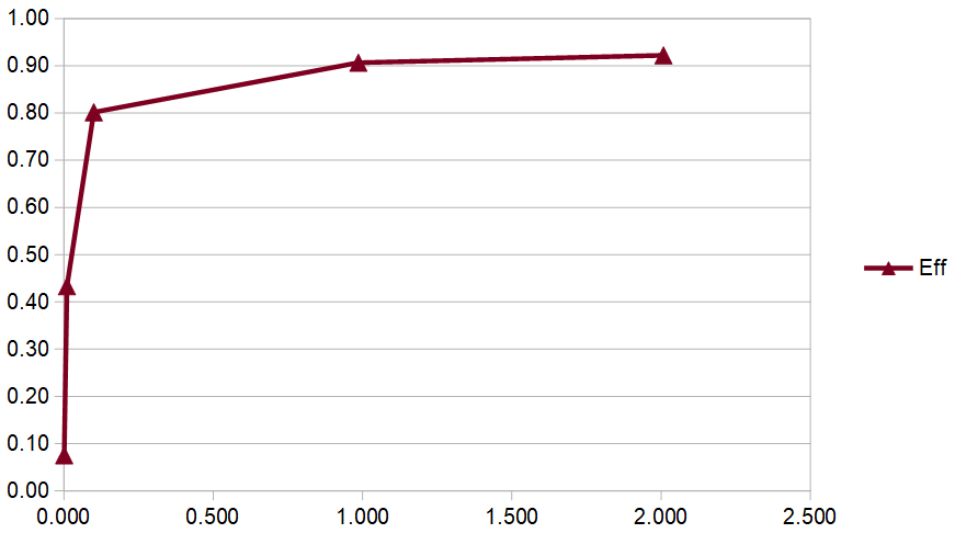

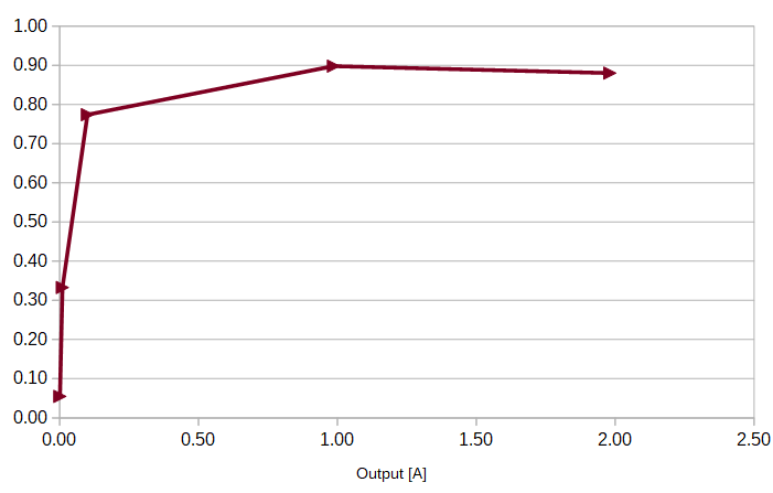

    Less of a concern at this stage, but maybe a clue, the power power efficiency seems particularly poor at low loading.
    Pin/Pout with Iout = 1 mA, 10 mA, 100 mA, 1 A, 2 A:

    This took us awhile in review.  Actually your efficiency does not look bad.  The layout can be improved because the AC current loop along the following path should be direct and compact, and enclose minimal spatial area:   GND-->QL--QH-->COUT--GND.  You may refer to the layout example presented in the datasheet.
    At light load, the losses related to voltage becomes remarkable with respect to the load power, causing the efficiency to reduce. Note that you always get 0% at no load no matter what you do.
    The thermal image just read 72.2C.  How could you get 106C?  Is the hotest device not the MOSFET?  By the way, what MOSFET do you choose?

    72C was after a few seconds at 2 A loading. But the temperature continues to rise and the 107C image was taken about a minute after power-up, just before the board shuts down (temperature monitoring circuit on the same board).

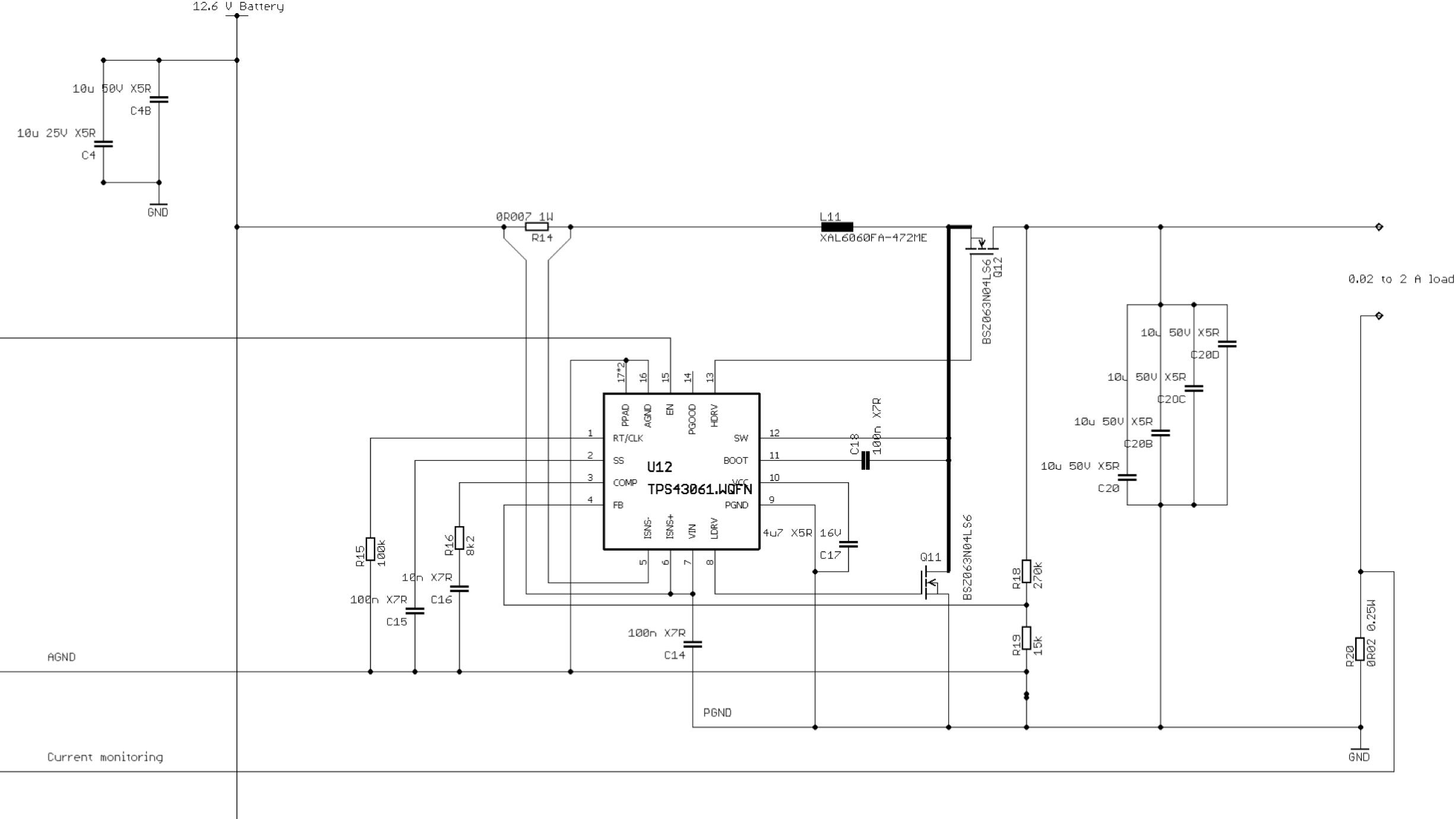

    This is the relevant part of the circuit (the FB resistors are currently slightly different, to get 27.5 V output, input voltage for testing purposes is 10 V):

    2 A load, after a few seconds:
    After 165 seconds:
    The two MOSFETs are very similar in temperature. But at the start we can see QH putting out more heat. QL is at a disadvantage by its position in between the inductor and QH.

    Thank you for the MOSFET info.  Its not a bad selection but you may need to improve your layout to get higher efficiency.  You need to follow the layout guidelines presented in the datasheet, and also refer to the TPS43061 EVM layout, and pay attention to the placement (I meant relative placement and orientation to minimize the current flow path) and routing for the gate drives.
    In your current layout, you gate drive trace from IC driver pin to the FET Gate, and the return trace from the FET Source back to the IC driver pins (PGND for the the low side FET and SW for the  high side FET), are not routed side-by-side closely.  This will introduce inductances and impact the FET switching.  You should not route traces directly under the QL pad in the inner layer, which can pick up switching noise. In addition, you did not have much heat sink for the FET, only using the small copper polygon on the top surface, which will cause high temperature in the FET.  If you  refer to our EVM layout, you can see that the  thermal vias are placed in the FET pad to help dissipate the heat.  You operation conditions are not far from TPS43061 EVM, and you should get better efficiency in an optimized PCB.

    There were some compromises made in the layout to suit the area and shape of the board, but I am still surprised about the penalty regarding efficiency. The board is odd-shaped and relatively small. There are also two of these convertors on the board, arranged side-by-side. The second circuit is not populated yet, but the Cout loop is more ideal and I will maybe test it also before ordering revised boards.
    Following your suggestions I will:
    • Get the Cout loop as tight as possible.
    • Route the gate signals around the high dI/dt areas and route the gate signal returns more closely.
    • Add thermal vias and copper area for the MOSFETs. Board area is restricted, but continuous full-power output is not required and with improved efficiency I can hopefully control the thermals.
    • Increase the Cout from 20 uF to 30 uF (or 40 uF if I can make it fit)
    • No other improvements to the circuit (e.g. adding filtering to the current sensing or using type 2 compensation)

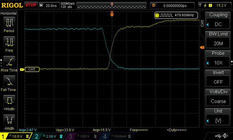

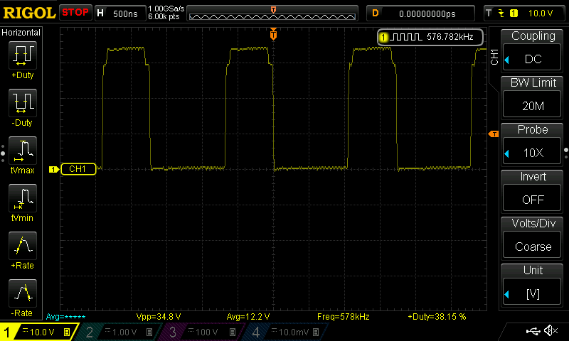

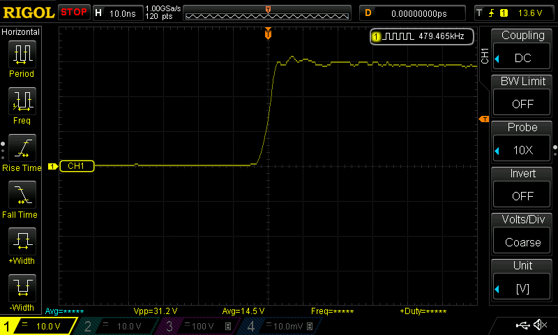

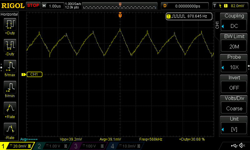

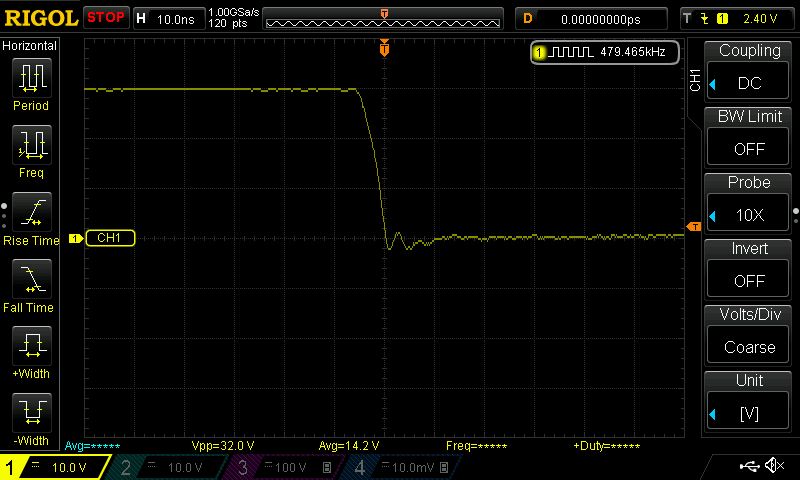

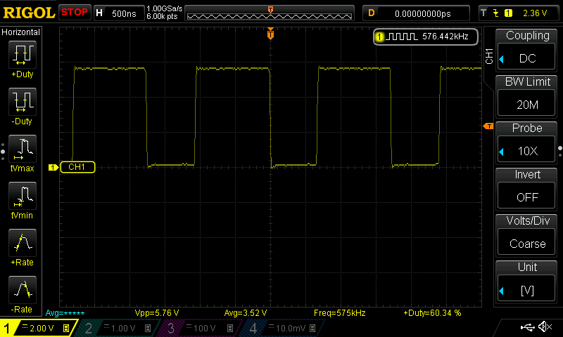

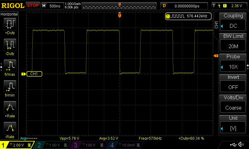

    I would like to confirm some oscilloscope images with you. All images are with 11 V 5.36 A input, 27.4 V 2 A output. All component values are as before.
    Switching node:
    QL gate drive:
    QH gate drive:
    Voltage across the sense resistor (0.007 ohm):

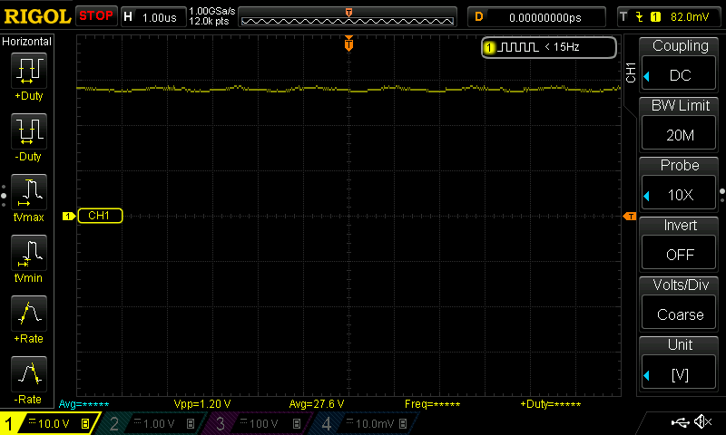

    Vout is good enough:
    Thermal image after about 2 minutes at full load. Hot spot is QL. QH does have a larger copper area:

    Thank you for the updates.  However, many of your attached pictures are corrupted. Anyway, could you check the MOSFETs and inductor temperature rises?
    Youhao
  • Hi Youhao,
    Sorry about that, not sure what went wrong. I re-posted my images in the previous post.
    QL rises to 100 C in 6.5 minutes, at which point the micro controller on the same board shuts it down.
    You can see in the thermal image above that QH and the inductor are a few degrees cooler than QL.

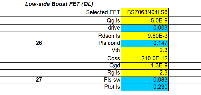

    I expected the switching losses to be very low. If I enter the MOSFET parameters in the TPS4306x spreadsheet I get this at 575 kHz:
    And if I calculate using my own spreadsheet I get similar values:
    Am I missing something? Did you conclude high switching losses from the oscilloscope images?

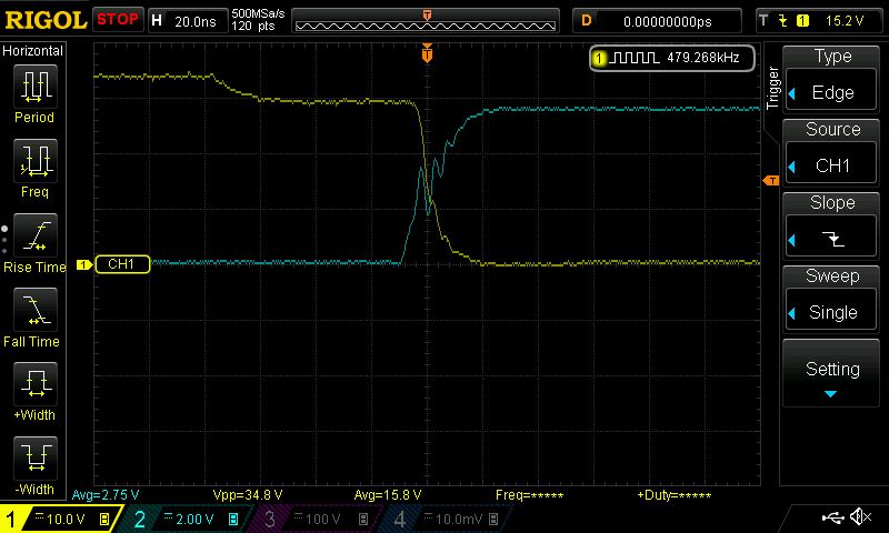

    Gate drive signals, measured at the PMIC, relative to ground:
  • Hello discrete,
    The blue signal in the second measurement seem to drop again close to the turn on voltage of this transistor. Please check this in detail as it could cause cross-conduction.
  • Hi Brigitte,
    Yes, I did not like that little ringing either. That signal is the gate drive for QL.
    But the switch-node looks reasonable?:
